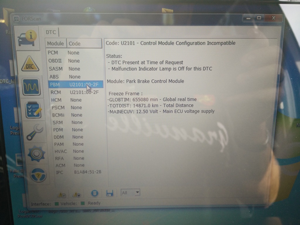

Hello friends!
I have 2 errors in module PBM and RCM, the code error is U2101 - Control Module Configuration Incompatible in each module.
The error appears when i change the type of engine in one smax with engine 140 PS to 150 PS Euro V. Other friends are make the some change type of engine and there isn´t any error.
My forscan version is the last available 2.2.3 Beta, my OS in Windows 7 SP1 32 Bits, and my obd2 cable is viaken stn1170.
Can you help me, please!
Thanks for all and best regards!

phoenix241 wrote: The error appears when i change the type of engine in one smax with engine 140 PS to 150 PS Euro V. Other friends are make the some change type of engine and there isn´t any error.
Sorry, we are afraid we don't quite understand. You said you changed the type of engine - how did you change it, exactly?

The problem appear when i change the engine type with ucds software. And i am search how i can resolve it!
Do you known how i can configure succesfully the rcm and pbm modules?
Thanks!
Re: Errors in module PBM and RCM in Ford Smax 2014
Current versions of FORScan don't work with modules configuration. We guess you need to address your problem to the support of ucds software (as their software have created this problem).
