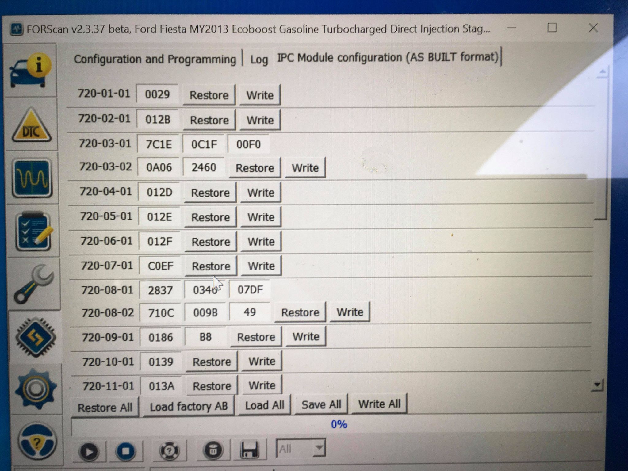

Grummy F150 - thanks for the detailed explanation. I'm trying to remove mykey from Ford Fiesta 1.0 ecoboost St line. When I connect and read from IPC I only have 1 set of numbers under 720-02-01 - do you have any ideas what is going wrong? Desperate to get rid of this mykey limitation and only have one bladed key. Any help appreciated.

So I’ve accessed FORScan but everytime I run IPC (AS built ) I only get two options 720-01-01 & 720-02-01. But I can’t seem to get MyKey Off. Also when I choose the other IPC option I only get two options As well which are languages & track key Enable or disable. I’m losing my mind trying to disable MyKey. I have a 2014 GT PREMIUM. Any ideas on how to disable it?

I did the below on my 2016 F150 and my 720-02-01 already had 20 for the middle 2 digits, so there was nothing to change and obviously still stuck with this stupid mykey. Tin foil on my blade key also does not work. Can't get the Mykey menu option to show back up. Any ideas?

Turn key on (No Start)
Connect to car in Forescan (save vehicle profile)
Access programming and configuration
Access IPC Mod Config (As Built)
First back up original module Then
Reprogram the module configuration in IPC Mod (As Built)
Under Mod 720-02-01 Second box of numbers, change the middle two digits ONLY to 20
Example 2CE4 should become 2204
Write all
The module will rewrite the entire mod
Turn key off and then back to on (No Start)
To verify
Go to ICP Mod Configuration (not as built)
Search using filter MyKey
Ensure all options for My Key are disabled
That completes process
Note: MyKey will no longer be available for the vehicle.

(Windows 10, FORScan v2.3.36 beta). I nearly pulled my hair out, too, because despite the ‘auto-switch’ claim, the tool did not auto-switch and wouldn’t read the IPC modules or any MS-CAN modules.
If using this tool, connect to it a laptop but DO NOT connect it to the vehicle OBDII jack. open FORScan, click the settings icon. Then click on the connection tab. Under ‘ELM327 specific’ change MS-CAN support from ‘Auto’ to ‘RTS relay’. Under ‘J2534 specific’ change MS-CAN support, change from ‘auto’ to ‘dedicated channel’. NOW connect the tool to the vehicle OBDII Jack, then click the “connect” button in the lower left-hand corner of the FORScan app.
The complete list of both HSCAN and MSCAN modules should now populate.
Once the list is populated, click on the ‘Configuration and Programming’ icon. Select ‘IPC Module configuration (AS BUILT format)’.
Press the ‘play/run’ button.
When the warning message pops up, click ‘okay’. Immediately click ‘save all’ and save the As-Built settings/code by naming it “IPC-original” or something similar. After saving the original settings, proceed with reprogramming the IPC.
It will take you to the IPC code screen. Here, follow tjtew79 instructions. “ Under Mod 720-02-01 Second box of numbers, change the middle two digits ONLY to 20
Write all
The module will rewrite the entire mod”
Once completed, cycle the ignition off and back on, and MyKey should be gone.
