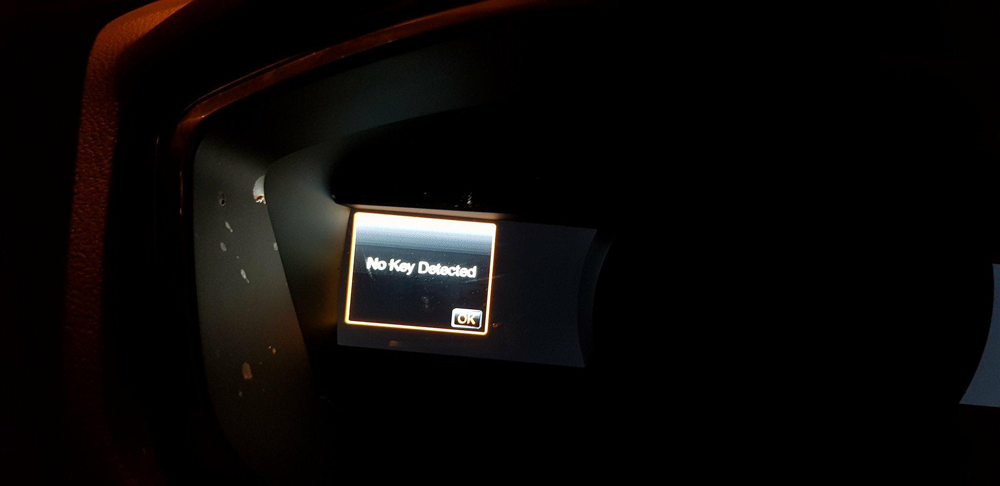

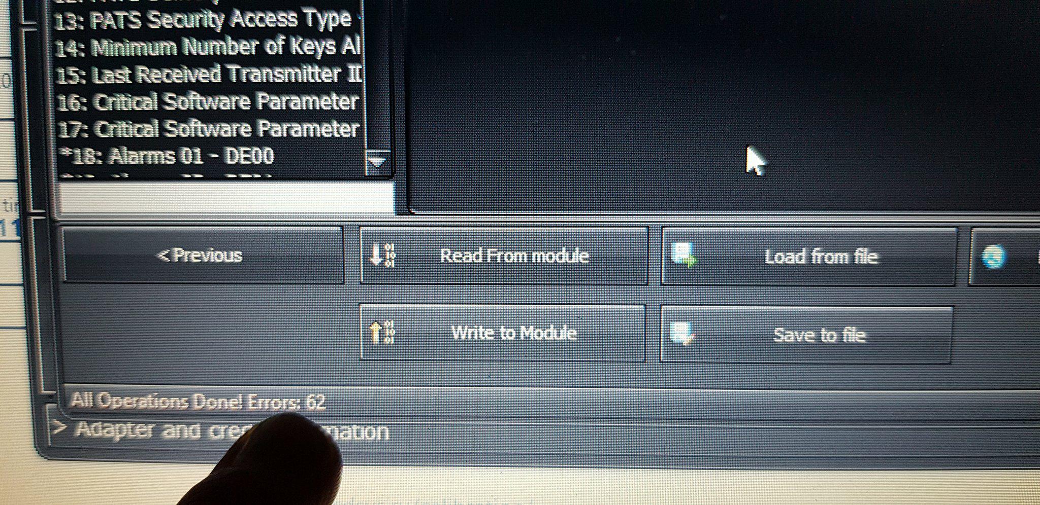

I have problem with Ford Fusion 2017. I read original configuration file from BCM.
Mistakely I write wrong configuration file from another Ford - I have file in the same folder ( nevermind ).

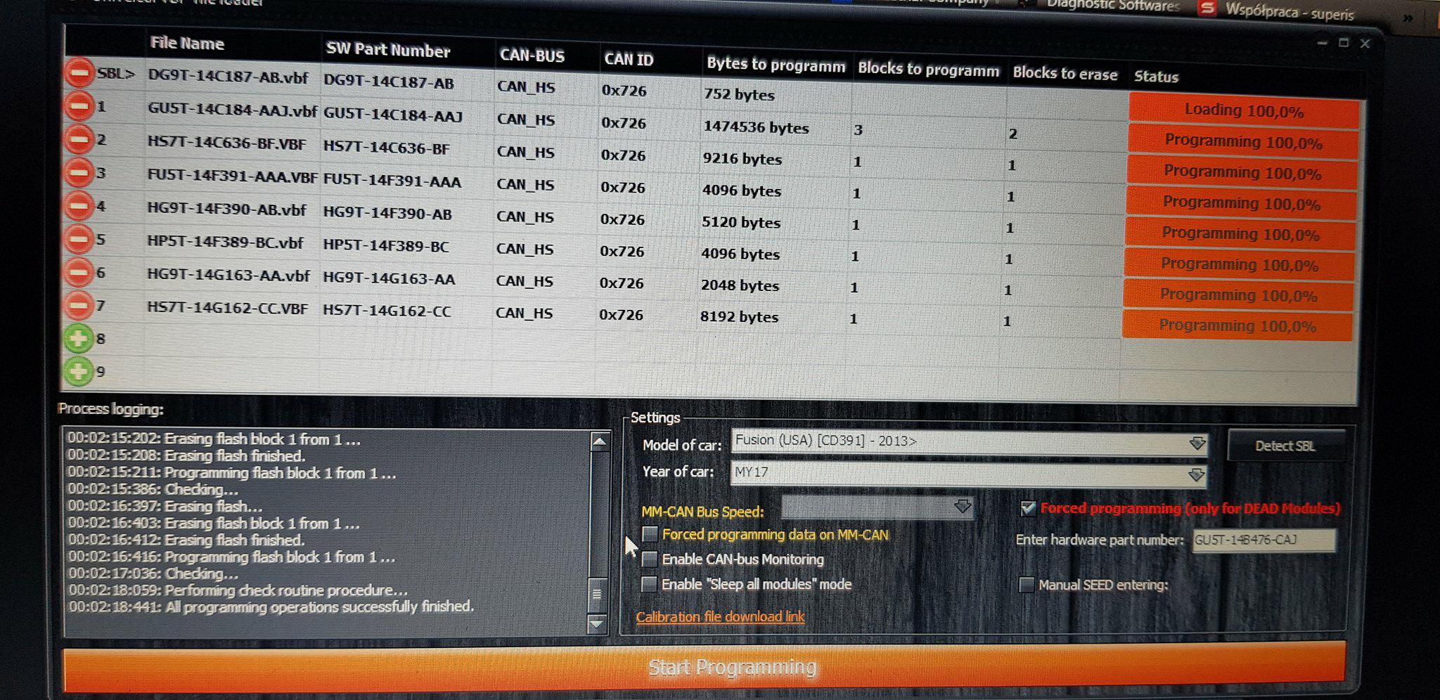

Now - Car won't start and don't see key. I flash BCM with vbf loader but I must write original configuration. Please help me - is option to write conf file to BCM without ignition ?

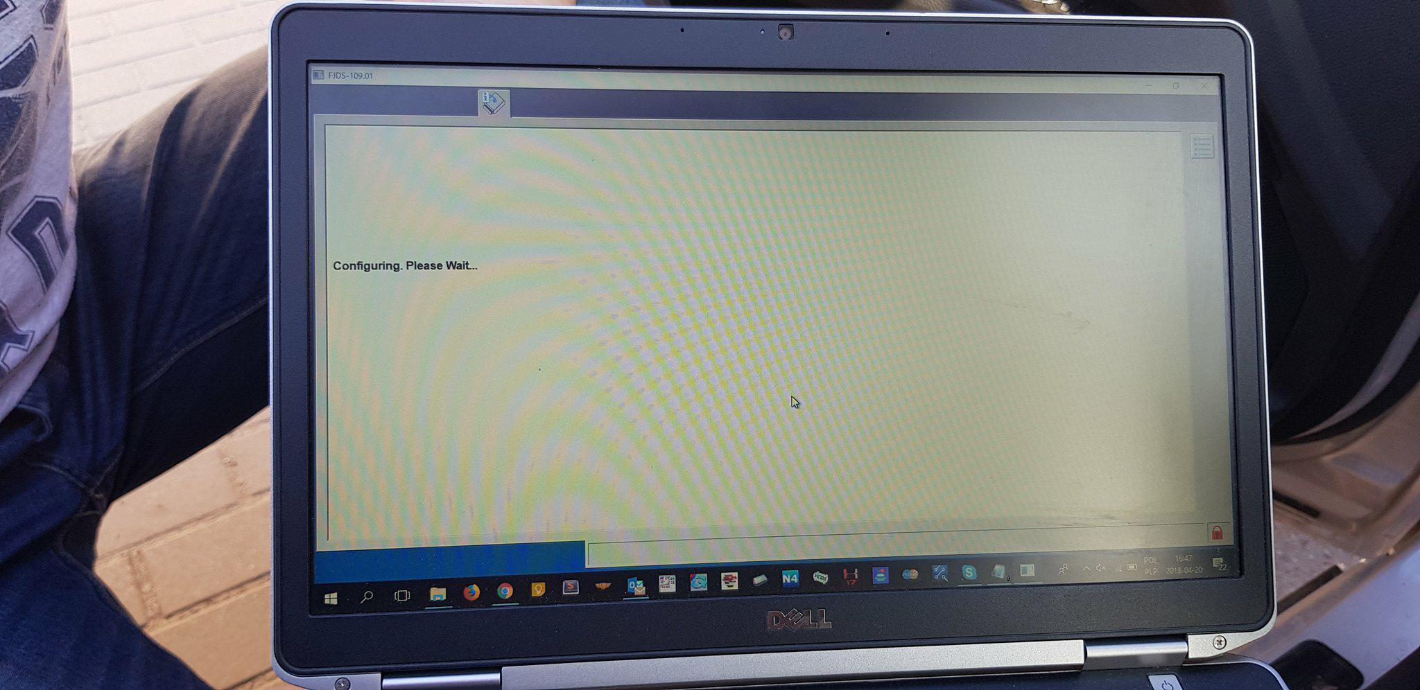

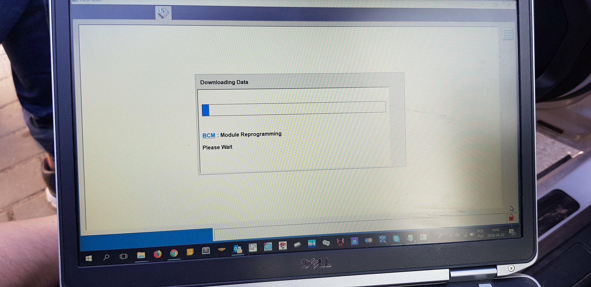

I buy account on FJDS Ford motorcraft service - USA for 2 days - reprogram BCM with Programable module Instalation - BCM - everything fine but configuration not upload done - Maybe anybody have solution ?
I think it's two important things keys and vin - I try open BCM module and check what memory is in. If eeprom I read it and check what data is in it. I know - to write back configuration or as built - must have access - ignition and working key. Ok try and give results.
