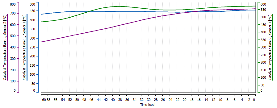

lapka, I seem to have very similar problems with my DPF in my Mazda6. Temperature sensor B1S2 shows very high temperatures during regen as seen in these two graphs. Is this more or less what you experienced as well? FORScan was the first OBD software to allow me to see the error codes nicely. Where did you manage to source the replacement sensor?
Situation during DPF regeneration. Sensor B1S2 rising rapidly
B1S2 over 800C and P2428 appears
pkomi
Re: which temp sensor is inside the dpf
Post by pkomi »
I have now also replaced my B1S2 exhaust temperature sensor and the previous problem seems to be gone. Monitoring the temperatures during auto regeneration do not show ridiculous values anymore.
