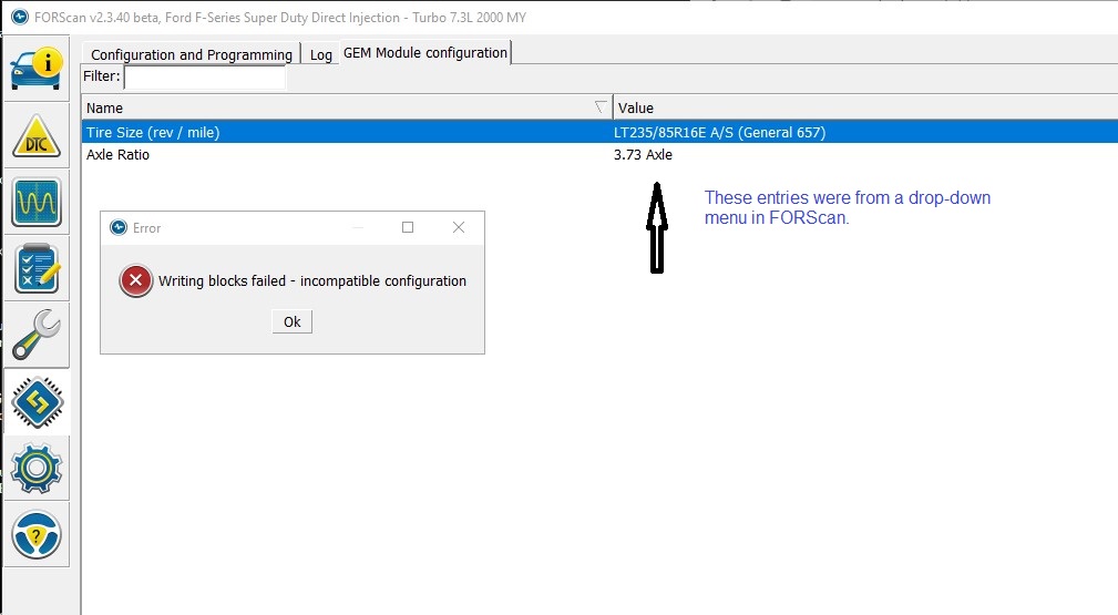

Okay, I don't get it. I am running the latest FORScan v2.3.40 beta.
I have a 1999 F350 Superduty
When I click on the item, I get drop down menus. I choose the correct item, but it won't write.
- Writing to GEM 1 Notation 2021-05-19 143849.jpg (79 KiB) Viewed 13437 times

This is what the v2.3.40 does. You choose the right tire size - mine is 657.

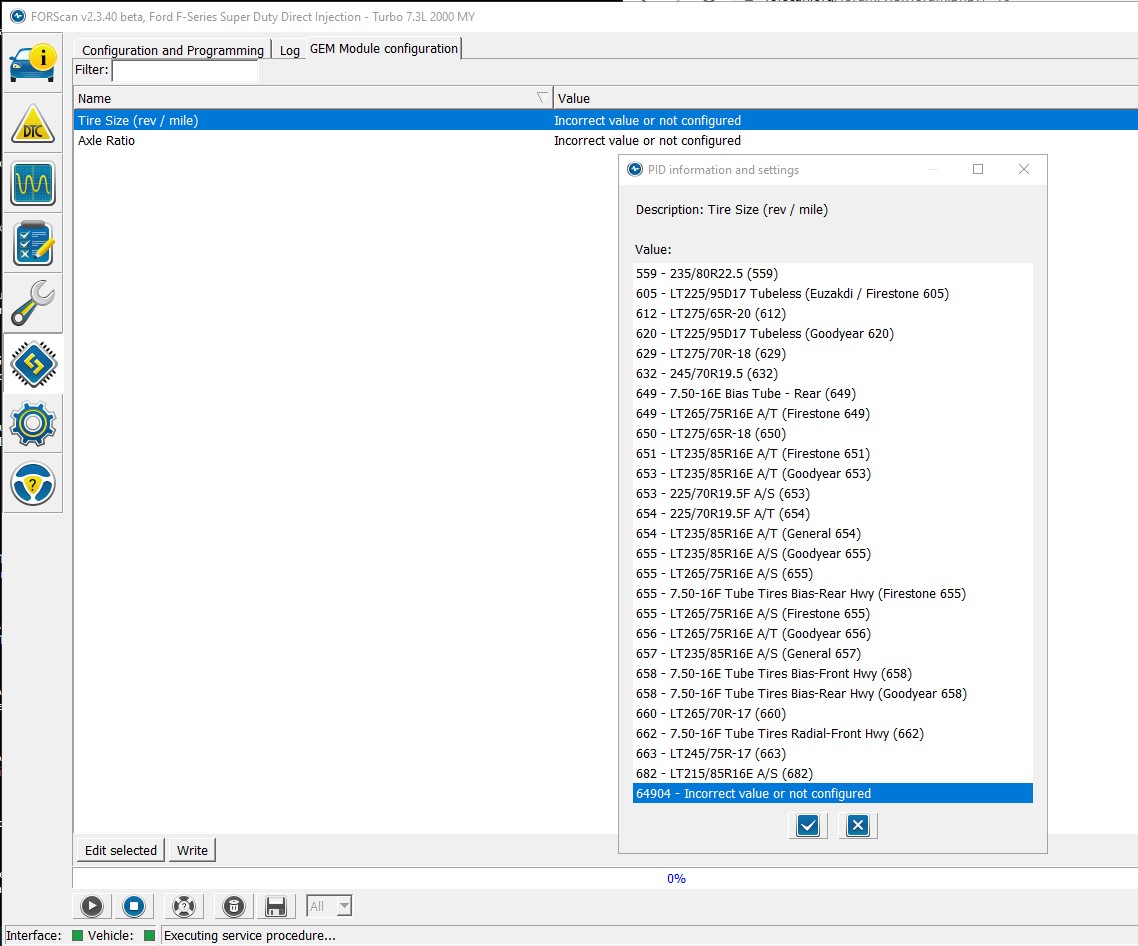

And this is what I get when choosing off the menu. I click "Write", then . . .

I found the options for pre-2015 vehicles to be pretty scarce. On a vehicle that old you may not be able to do much at all with Forscan. You might consider looking for an add-on aftermarket module.

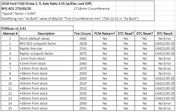

For those of you with a 2017-2020 F150 (with 10 speed transmission) and are having DTC errors after writing your tire circumference. I've done quite a bit of research on this and did some extensive testing today. Here are my results:
After attempt #15 I stopped and took the truck for a drive. The speedometer is off about -2.5mph at 70mpg. Actual variance reported on my phone with GPS was fluctuating between 2.3-3.1mph. It's also noteworthy that I did not have to do a DTC reset after a PCM relearn for the attempts with no DTC error.

Before these 15 attempts I tried programming my speedometer with mixed results. I tried the true circumference of my new tires (2718mm) and received DTC error (not visible on dash) which I wasn't happy about. I left it because my speedometer was off just a touch. I ended up changing it to a number that I saw on these forums 2645 (or something like that) that somebody else tried with no DTC error then my speedometer was showing me faster than my GPS which was really odd. During this attempt I still had a DTC error which is what caused me to do so much research that resulted in the 15 attempts I just posted.
Thoughts
My research has shown absolutely no patterns to why some people with 2017-2020 F150s are getting DTC errors and some people aren't. It makes no sense to me why the maximum value I can program is 2501. I suspect that if I were to change the axle ratio I could set higher than 2501 but I do not want to do that. It's also possible that there is a bug in the version of FORscan that I'm using; possibly with a new revision my results will be different.
My speedometer was off -5mph but now its only off -2.5mph without any DTCs. I guess I'm happy with this unless somebody else has any other ideas.
