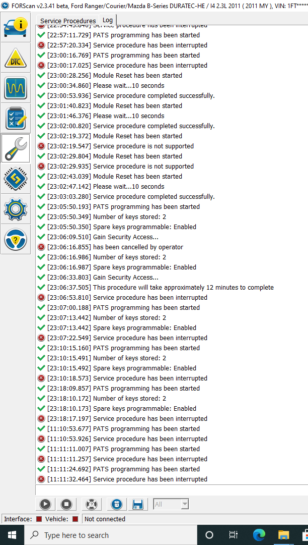

I have this issue. Everytime I try to program a different cluster (Pats) it just says procedure interrupted. If I put the original cluster in it will let me do anything add keys, module initialization etc.
Rn everytime I do as built configuration on the used cluster it will say it was reset to as built (on forscan) but after I turn the ignition on and off it just goes back to whatever it was before using as built.
Rn with the used cluster I'm getting error B1260-FF (theft detected immobilizing engine) but with original cluster it will start right up.
This is my first post. I just don't know what to do.
