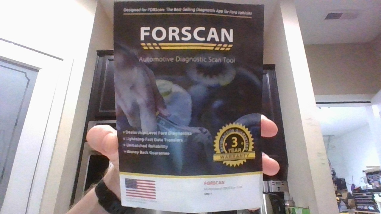

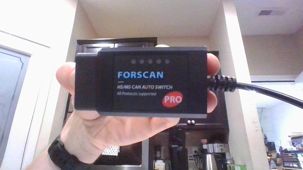

Asking for a "friend".. If I were to be using one of the Chinese adapters could that be the reason not all of the modules are present in FORScan? I borrowed one from a friend and pretty sure its a bad Chinese version. Plugged into my 17 Fusion Sport I only see the PCM, OBDII, APIM, PAM, BdyCM and BECMB modules.

FFan628 wrote: Sat Oct 02, 2021 9:23 pm Asking for a "friend".. If I were to be using one of the Chinese adapters could that be the reason not all of the modules are present in FORScan? I borrowed one from a friend and pretty sure its a bad Chinese version. Plugged into my 17 Fusion Sport I only see the PCM, OBDII, APIM, PAM, BdyCM and BECMB modules.
Has it got a Switch ?? ...Is it WIFI ?? USB??

It has an auto switch built in, is USB. Package says designed in America but not made.. I am just trying to figure out why I don't see more modules. Granted this is my first time playing with FORScan and I have adjusted the settings for the scanner in the app but still no other modules show up.

FFan628 wrote: Mon Oct 04, 2021 1:14 am It has an auto switch built in, is USB. Package says designed in America but not made.. I am just trying to figure out why I don't see more modules. Granted this is my first time playing with FORScan and I have adjusted the settings for the scanner in the app but still no other modules show up.
This is exactly the adapter that Forscan, in the opening post of this thread, was warning about!
I suspect that the auto switching is being done by an RTS relay instead of MSCAN Support being done in the actual PC Board configuration like the OBDLink EX or the vLinker FS adapters!
Changing the MSCAN parameters in the Forscan connection Icon from Auto or MSCAN switch to RTS relay may or may not help bring up the MSCAN bus and the modules on it! There is also the likelihood that this car has an HSCAN2 and possibly HSCAN3 networks which in some cars is also accessed over the MSCAN pins and network
I have seen reports of these having the MSCAN support miss wired or actually missing!
It would seem this adapter is missing MSCAN but without taking it apart I have no other Idea!

Nukin futs.. Ya I kinda figured it wasn't very legit after using it the first time and will invest in a good adapter but will also tweak the settings again to see if it will pull other modules.
