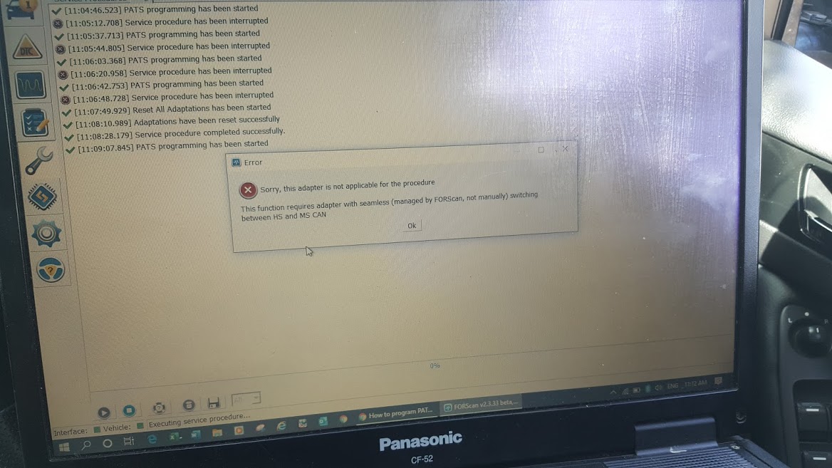

Guys , I think i may have to follow this solution or also seek more advice. This is what comes up see attached photo. I am trying to do a PATS reset as i have lost my wife's only set of keys which i got a key code from Ford Australia to have keys cut to enter the car. I purchased a USB to OBD2 with a manual switch and now it is asking for auto switching . Is there any other way for example blue tooth etc. I have been reading post to find a solution.

ELS 27 could be the solution a person suggest this on Ford Forum i will let you know it it works for me

KelB wrote: Thu May 14, 2020 12:08 pm Is there any other way for example blue tooth etc. I have been reading post to find a solution.
Have been using one of these on a BA XR6 Turbo 2005 and Mazdas
https://www.obdlink.com/ex/

I would strongly doubt it and the PIC 25 chip is not the chip that needs the modification! Since this mod was done the RS232 USB to Serial chip has been changed and some have found the RTS Pin behaviour has changed and the relay will not switch between the busses in the way this mod works(See a couple of posts above)!
Also the this mod is not much faster switching than a manual switch is and FORScan has developed to the point where the only adapters that will work with FORScan must now have internal Buss switching as per the FORScan adapter recommendations on the FORScan Products Page(see also a few posts above)!
I have tried this and with the price of the parts needed and the problems involved in it (I ruined my OBDLink SX trying this), I would for the price just go and get an OBDLink EX or a vGate vLinker FS.
I can Guarantee you will be much happier!
