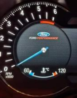

Re: Mondeo MK5 IPC firmware
Please, how do I get the effect of photo #3?fordsmax471 wrote: Sun Jan 09, 2022 8:29 am if you want to change the colors and design of the needles and other components, write to me![]()
Thank you.
