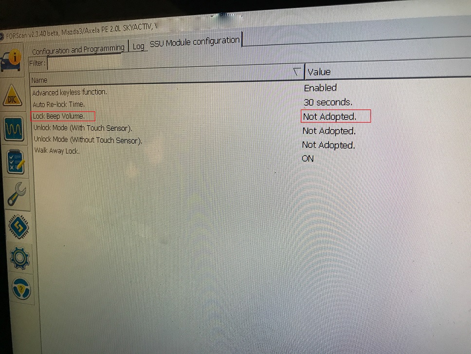

I have ( Mazda 3 2015 Axela PE ) and I need to turn on lock beep volume (I MEAN I NEED TO HEAR HORN WITH LOCKING DOORS BY REMOTE) but when I get the SSU Module Configuration I found:
Lock Beep Volume. Not Adopted.
when I try to turn ON >>> it gives me error !!!
There is anyway to fix this by SSU ASBuilt Configuration ? or can you explain to me what is that meaning if you can ? :?: :roll:
Is that means my car's horn not connected with the computer? If it is true, Is there anyway to connect it ? :?:

You need to change the data of RBCM. You can press the lock key twice and the car horn will sound
