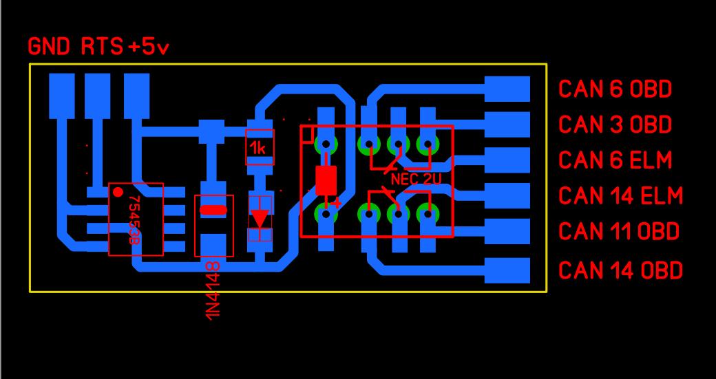

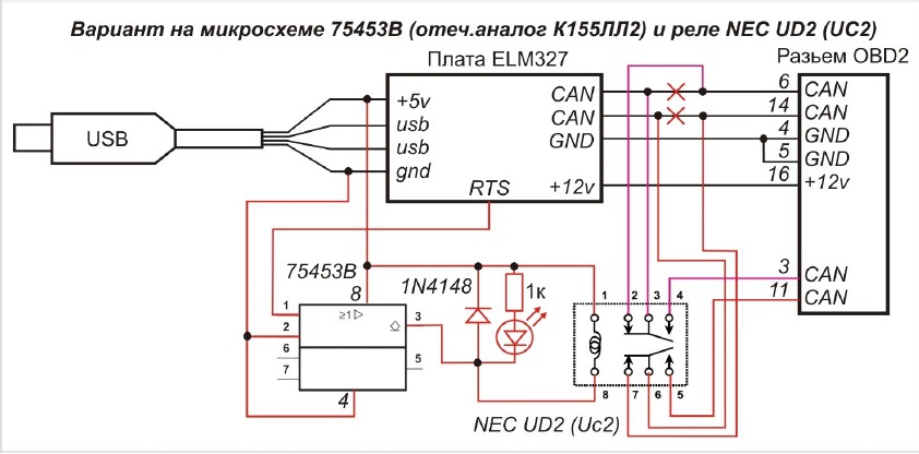

What is RTS Relay? Is it auto switch from HS to MS? If so, how to do it?

There is no article on English yet, in general it is a small board to switch between MS and HS CAN by signal from RTS line of COM port. It is more complex than mechanical switch (requires more skills), also at this moment it is only applicable for USB adapters. Here are some schemes:

Does this work with every USB-UART chipset? My USB adapter contains Prolific chipset PL2303.
Is this relay type latching or non latching?

Will look for parts and build this small pcb,...
