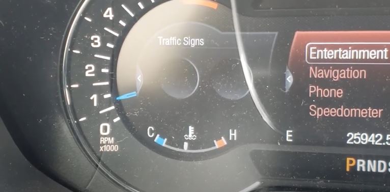

Hi any idea on how to display TSR on the left side of IPC
My current setup

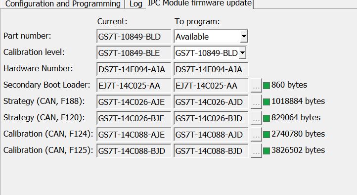

Depends which firmware you have on the IPC. I have the Mondeo cluster in my Fusion and Ford killed speed limit signs in 2019, if your anything at or past those dates your IPMA won’t have TSR ability. Just like me. I have a buddy that can downgrade if you’d like to contact him let me know.

Hi, I have 2020 Mondeo MK5 and also I have TSR just when IPMA reads it. When I change it in module from Camera to Camera+Apim, it saves but when I go back to the module, there is again just Camera. Do I have to downgrade ipma FW to make it work?
