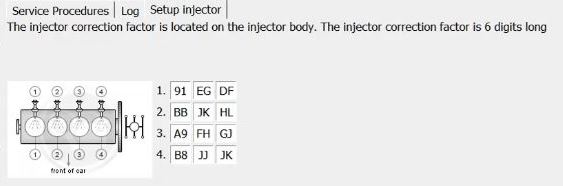

Forscan - Read injector codes. The codes are nothing like as above. The correction factor is not on the injector unless 030018 is it.
Can someone explain the differences?

Why does the QR show all numbers and not as is in Forscan?
QR - 1 - 122930 1477 030018.
Forscan - 1 - 91 EG DF

QR = 1 122930 1477 030018 - 4 digits mid' column. Forscan = 1 91 EG DF is 6 digits. It is not possible to enter the QR codes.
