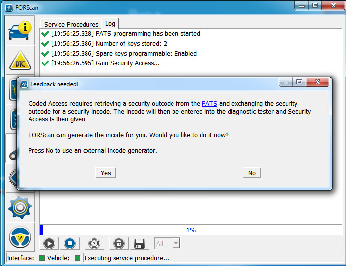

- Run the procedure. We see that PATS knows 2 keys:
- Select the Ignition Keys Erase option. FORScan will read outcode and suggest you to generate an incode using the built-in generator:

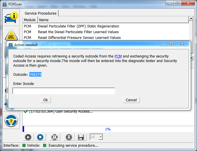

You can accept and generate incode using built-in generator, or refuse and use an external incode generator. In this case FORScan will show you the outcode and ask to enter the incode:
You can use an external service, for example autokeyprog.com to generate the incode:
If incode is accepted by PATS and if everything is OK, FORScan will request confirmation on the Erase operation. If confirmed, the operation is executed and user is returned back to the main menu. User should see now zero keys known by PATS.
It is important to do not Exit from the menu, otherwise the security access will be lost, and user will have to obtain the coded/timed access again.

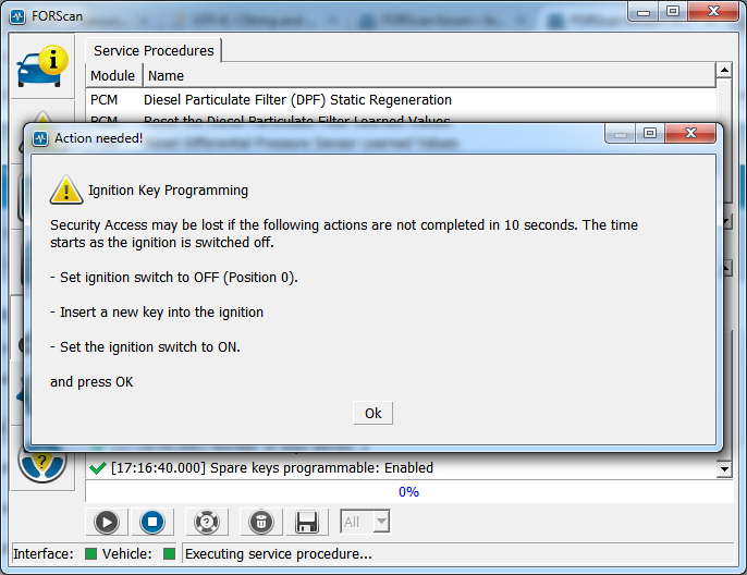

- Now, user should program 2 keys. For this purpose the Ignition Key Programming option must be used. User will be suggested to program the key:

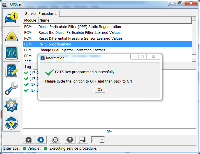

- User should follow the instruction displayed by FORScan, so turn the ignition key to OFF, then back to ON and click OK. FORScan will confirm the operation and ask to turn on/off again.
It is important to leave the programmed key in the ignition lock, because number of known keys is non-zero and FORScan will look for a master key.
- program the second key in the same way, except that when FORScan asks to insert new key, the first key has to be removed and the second key has to be inserted.
- When returned back to the main menu, user should see 2 known keys again. But this time these 2 keys are in hands.
