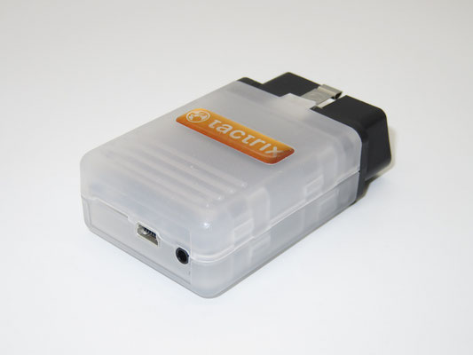

Tactrix is also a good product but most are clones. People in the AU use the Tactrix as a J2534 programming device with success.
One problem with Tactrix is Medium Speed CAN connection.

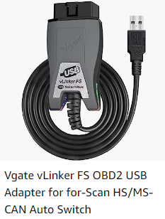

You'll need the VGATE vLinker FS cable or OBDLink Pro FT J2534 cable. Tatrix OpenPort 2.0 will work as well but is a more limited J2534 as it doesn't support MSCAN. If you plan on using PCMtec at some point, get the OBDX Pro FT.dant1612 wrote: Fri Jul 28, 2023 5:11 am Hi,
