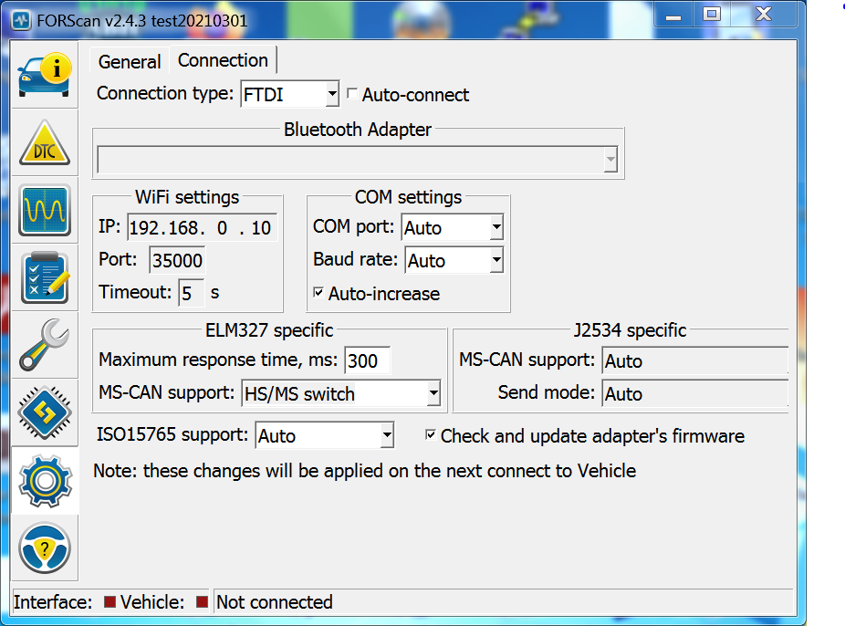

FORScan's Connection parameters(Gear Icon/Connection Tab: Connection type set to FTDI and not using auto connect) should also have the ELM327 Specific MS-CAN Support settings set to use HS/MS switch!

Chances are good that if your "Dodgy" E Bay adapter used FTDI drivers then the EX adapter will be already set up! The connection parameters I use for my old OBDLink ElmScan5 are shown in the attached .png file and should work for an EX adapter and the only exception or difference for an EX adapter would be to set the MS-CAN support to "Auto" and Check the box for "Check and Update the adapter's Firmware" The EX is chip firmware Update-able and I would bet most of the E bay clones are not!
