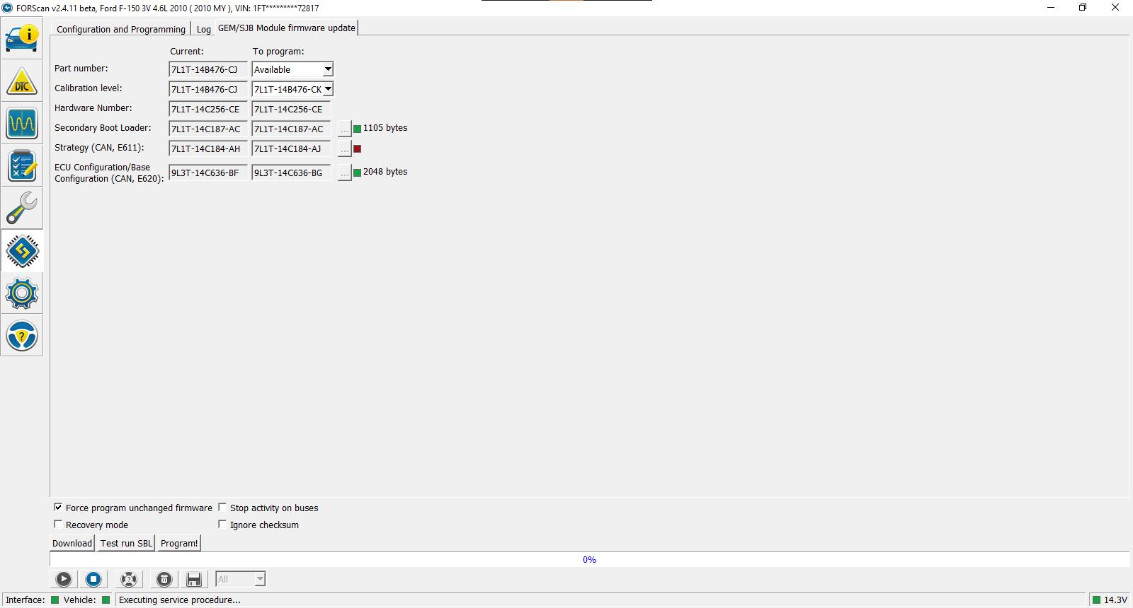

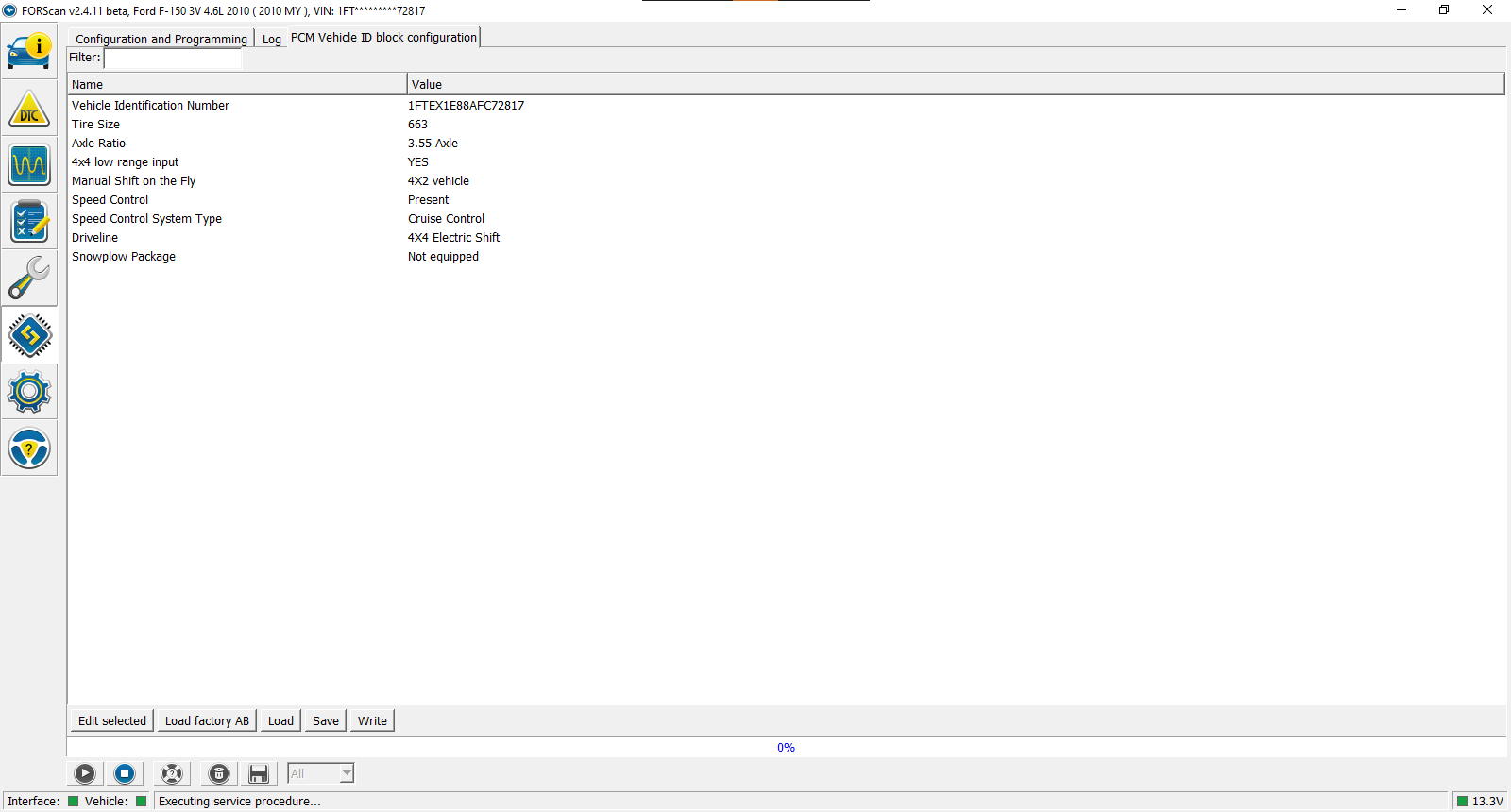

Hi there, I have done a PCM firmware update on my 2010 F150, successfully activated cruise control in the PCM VID modification section, but I still am unable to activate Cruise control using the steering wheel buttons.
I have tried to update the GEM module firmware, thinking maybe it is the issue but I can't update it as it fails to download one of the files.
Is there anything I'm doing wrong?
Using VLinker FS cable, latest beta FW of Forscan and have internet connection.

Trying to update GEM Module Firmware 2010 F150
- Capture d’écran 2024-04-01 142900.png (63.81 KiB) Viewed 2735 times
- Capture d’écran 2024-04-01 142802.png (70.91 KiB) Viewed 2735 times

But everything works, except cruise control. I had suspected I would need to get someone to program it using IDS or some ford tool but with this version of the Beta, in theory, it should work.
I'm confused as to what I can do to make it all work, as now the only mismatched VIN i have is for the RCM. I think I used to have mismatched VINs on multiple modules but forscan isn't reading that anymore.
Mileage is correct on IC as I kept my cluster from the XL.
Cruise control light turns on when testing the cluster, but will not activate on the truck while running etc.

Turns out when I did all these steps it was successful, I was trying to set the cruise but it wouldn't enable itself. Fast forward to today it worksbotus wrote: Sun Apr 07, 2024 10:24 am Not sure if this helps - check out this post - it refers to an issue setting up cruise... some models don't have it within the PCM you have to add it
