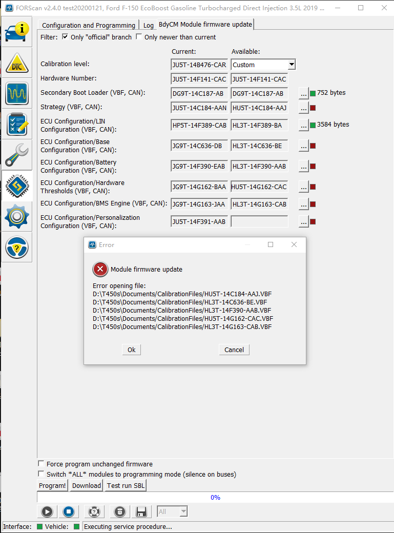

Help! !! !! v2.4.0.test202000121 refreshes BCM crashes

The OBD voltage is 12V, and the key is 12V on or off.
OBD connected and disconnected operation results are the same

all fuses normal
update 14F389

Did you have a decent battery charger connected when you tried to flash the BCM?. My Kuga required a 12amp charger.
Also I'm sure I've read on here ELM adapters are no recommended for Module Updates?.

The external charger has been connected, the guaranteed voltage is 12.5V, I just want to test,I'm using ELS27, not ELM

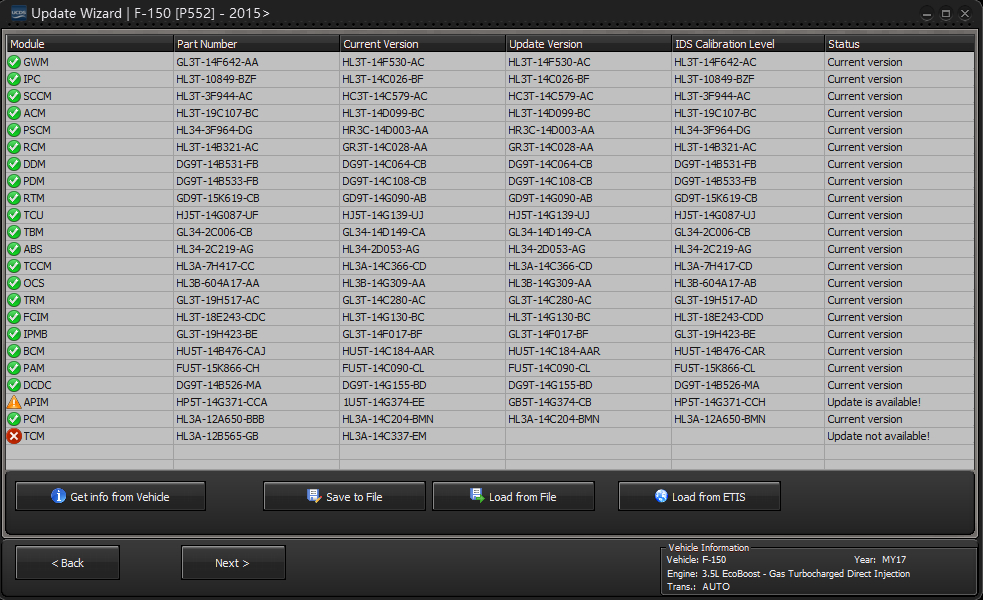

Now I have used UCDS repair

Priscila.Guerini wrote: Sat Apr 11, 2020 8:19 am Did you repaired the BCM module work with UCDS?
Has been repaired, and all modules have been upgraded to the latest version
