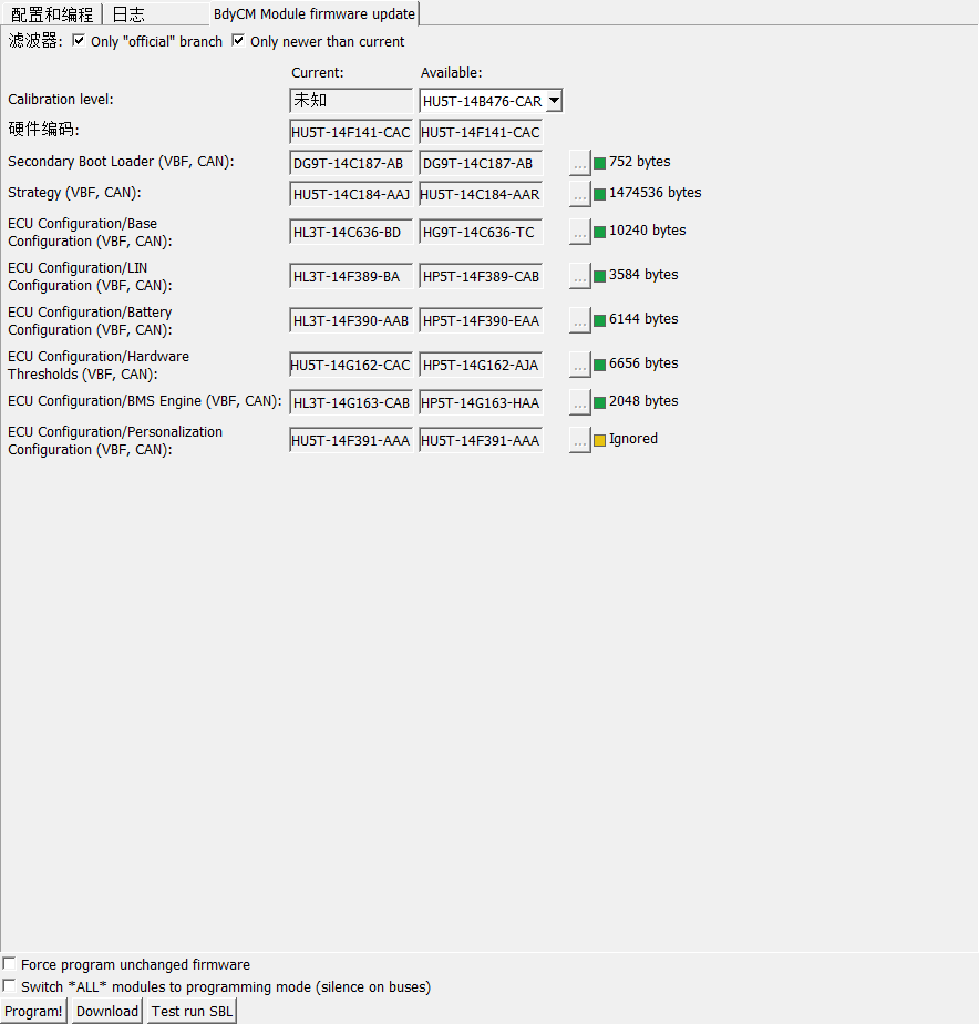

ESL27, the firmware update is automatic, everything is normal during the update, after the update, the car does not respond after opening the key, just like the power failure, now the OBD is no longer connected

Using ELS27 to update the firmware, now the car is like a power outage

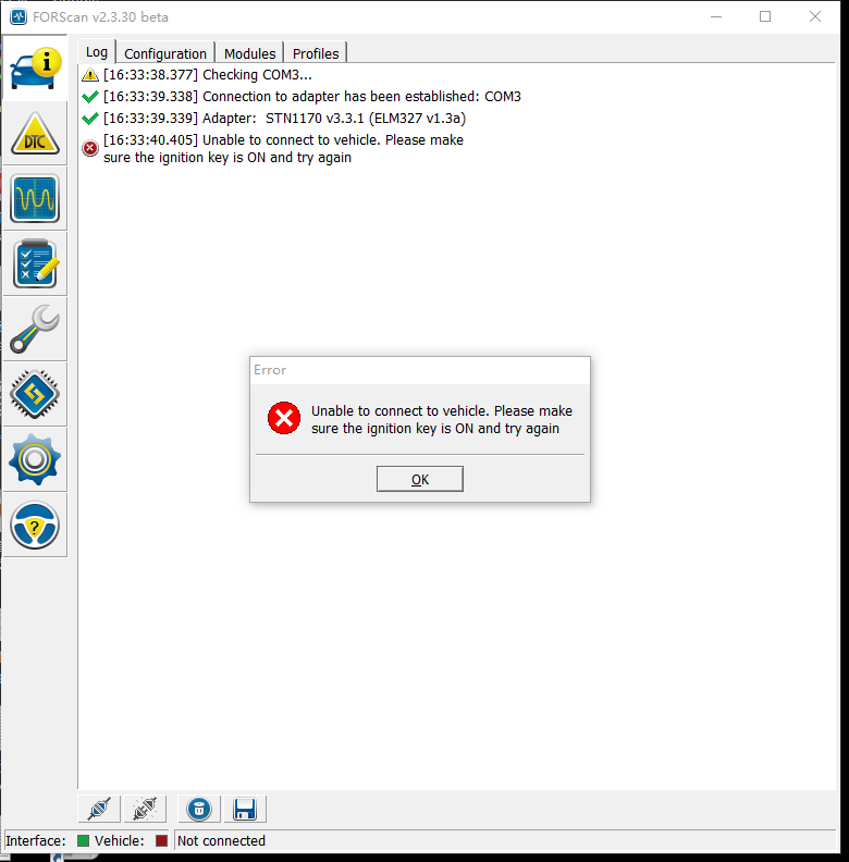

ok
we check if the adapter and software are okay
connect the adapter to the computer and run FORScan without the car

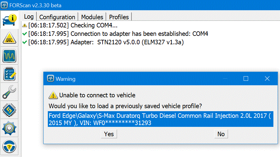

if you still have an old profile then press "YES"

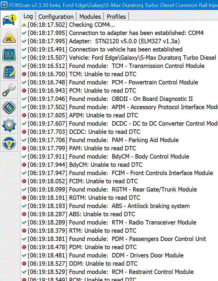

Re: Help! !! !! v2.4.0.test202000121 refreshes BCM crashes
if the adapter and software are in ok you should get such a picture

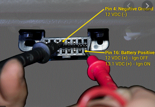

and also measure the OBD connector on the multimeter
