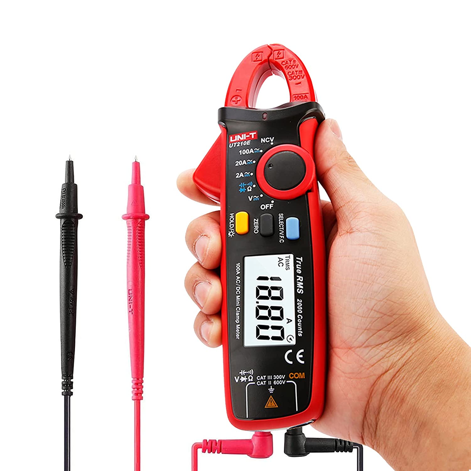

Instead of posting this nonsense, get one of these tools and LOOK AT IT!
UNI-T AC_DC.jpg (125.97 KiB) Viewed 2354 times
KOEO - Attach the clamp and test the parasite at the negative cable first.
KOEO - Attach an AMP clamp to that mickey mouse POS battery charger, what is the current output?
Answer - Less than the parasitic draw.
One way or another, the system will fail and force it self to sleep. Worst case, "Another Brick In The Wall".
One more time, a POWER SUPPLY is recommended, NOT a battery charger.
The one that I use is a 90 AMP floating power supply and can remain attached all year long with NO damage to the system.
