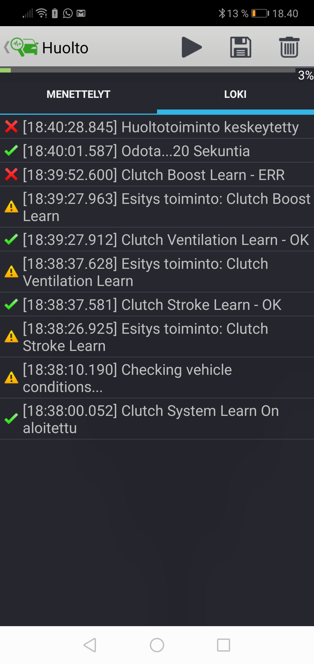

why clutch learn always stop me clutch boost learn now? half year this go fine... but now stop always same. no fault codes.?
- Screenshot_20191030_184044_com.astech.forscanlite.jpg (446.36 KiB) Viewed 12101 times
Re: Testing learning functions for Powershift 6DCT450 (MPS6)
and shiftfork learn cant complete too.. but gearbox works good. and not problem. i just want do this learns again. this all learnigs compelet fine half year ago.. and not now.. do i have problem my elm.. i hope not the gearbox
