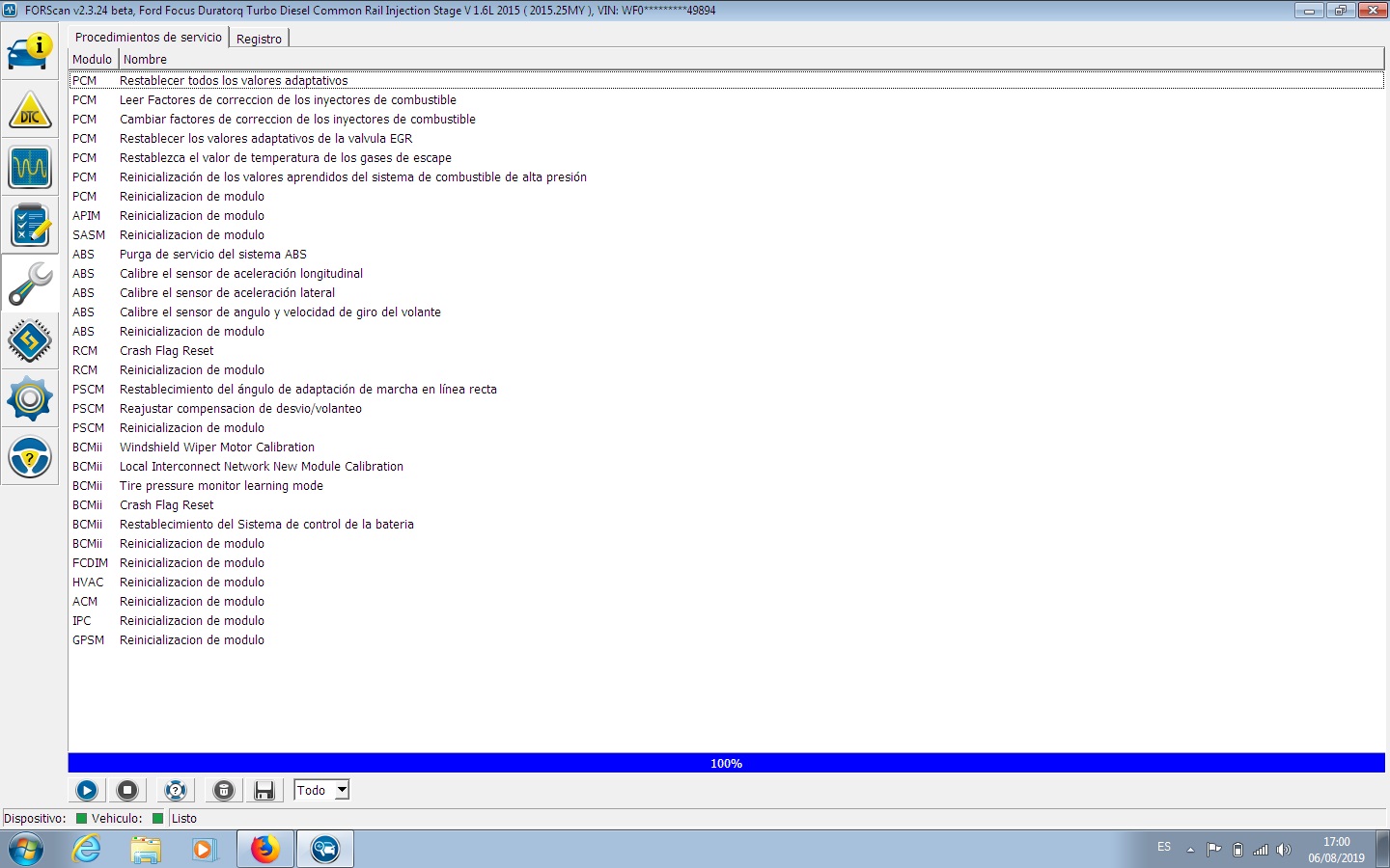

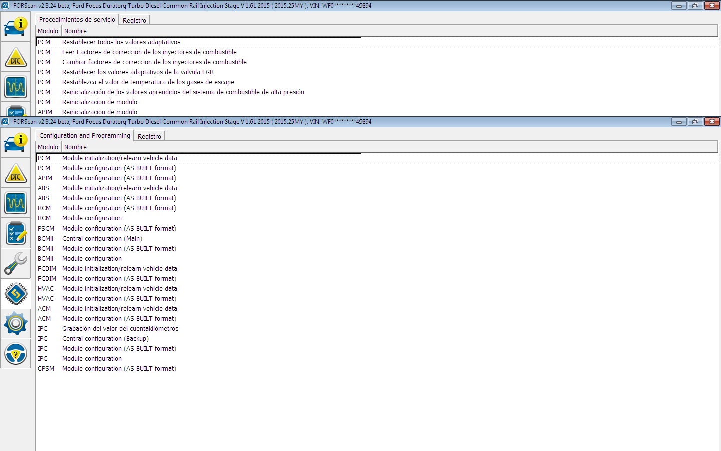

Re: How to program PATS using FORScan v2.3.*
In my car, no have PATS option...
