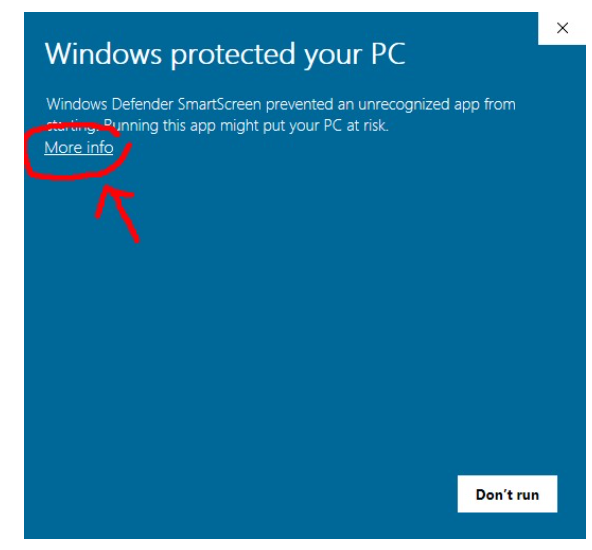

I am getting a malware error when trying to install the latest version 2.3.37.
Re: Antivirus false positive
Whenever we make a new upgrade and create a new build to distribute to our users, Windows may temporarily block the installation because the file is new and Windows doesn’t have enough information to guarantee its safety. It can take a few weeks for Windows to remove this warning. Luckily, you can accept the downloaded file

I was able to exclude Forscan from my virus scan and it now works.
