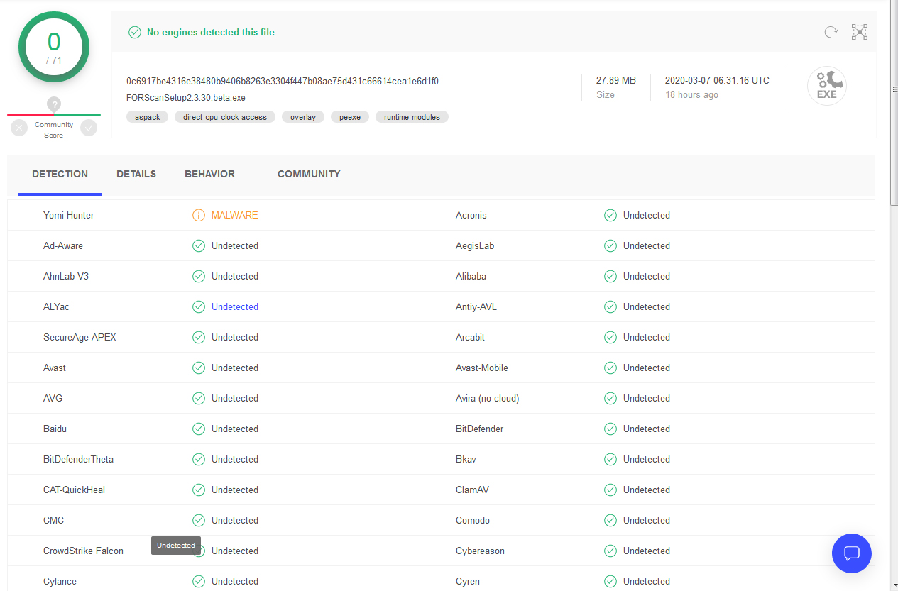

We have released v2.3.30 yesterday and tested it on Virustotal to make sure there are no false alerts. Here is the report:

FORScan wrote: Sun Mar 08, 2020 12:59 am We have released v2.3.30 yesterday and tested it on Virustotal to make sure there are no false alerts. Here is the report:
Thank you very much for your great support, I would like to confirmed, forscan V2.3.30 is no problem about that. I can install and it's working fine from now.
