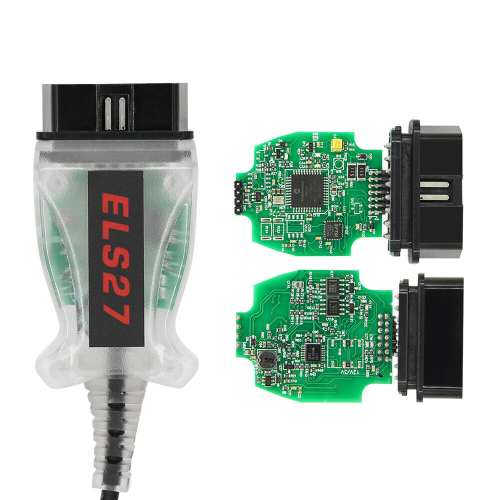

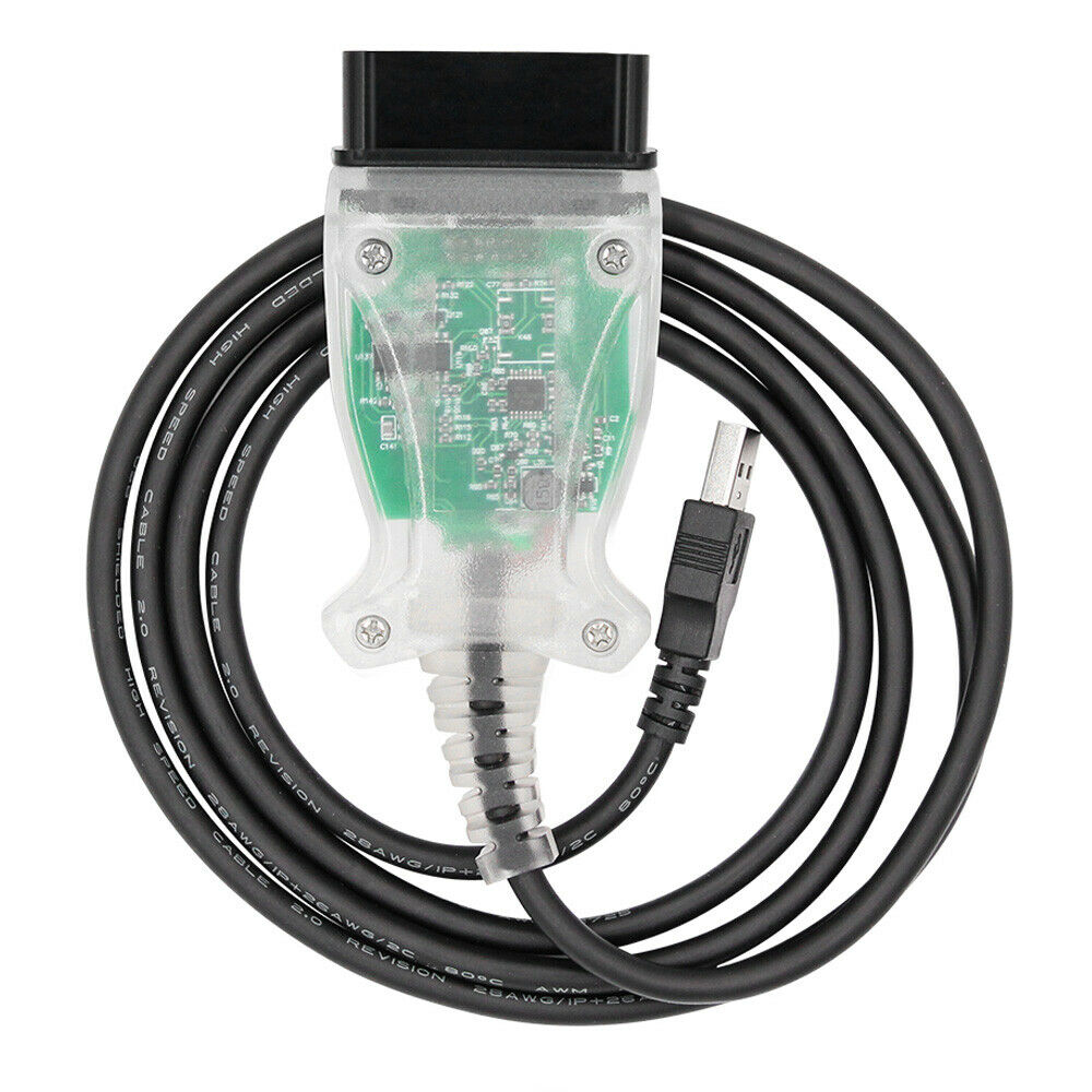

A good ELS27 Clone
$30 ELS27 clone connected 2006 Mazda 3 very well. Locally shipped in Melbourne Australia. Can only comment on that particular use case.
All modules on HS-CAN and MS-CAN appeared on connect. Connected at high speed and low latency. Using Forscan for Windows, USB adapter.
Think its using
1. FTDI FT32RL UART to USB
2. STN1170 v3.3.1 (ELM327 v1.3a)

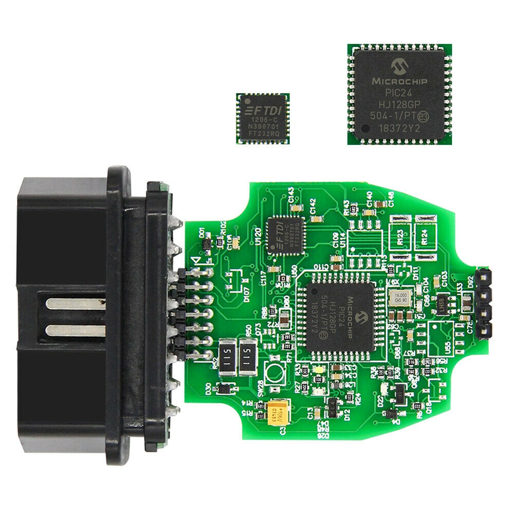

- double sided - s-l1600.jpg (148.53 KiB) Viewed 22021 times
- Chips - s-l1600.jpg (159.19 KiB) Viewed 22021 times
- Cable - s-l1600.jpg (127.28 KiB) Viewed 22021 times
identificator
- Posts: 5
- Joined: Sun Sep 13, 2020 8:12 am
- Vehicle: Kuga 1.6 182л.с.
Re: Attention - bad clone of ELS27
Equal to previous one, it's a GOOD clone (outfit is equal):AndyGeorge wrote: Mon Jul 27, 2020 12:32 pm All modules on HS-CAN and MS-CAN appeared on connect. Connected at high speed and low latency. Using Forscan for Windows, USB adapter.
Microchip
PIC24
HJ128GP
504-I/PT(88)
1642VWV
FTDI
1703-c
D9263701
FT232RL
Mondeo 2007 was read and performed "error clean-up"
Kuga 2014 was read and Cruise-Control was configured.
