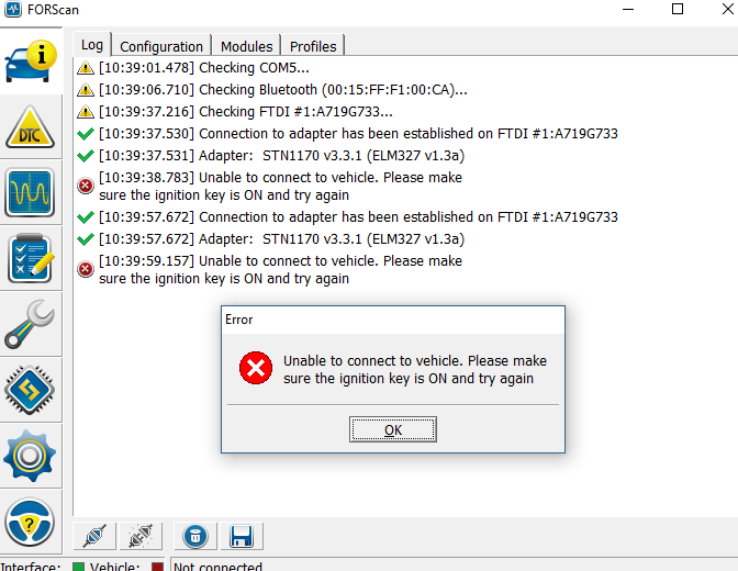

Well, since the price was 1/2 of the "official" ELS27, I have tried my luck:
https://www.aliexpress.com/item/2016-Ne ... 91112.html
Results on my 2001 Ford Explorer and 2001 Mercury Sable are as attached:
Re: Attention - bad clone of ELS27
A real ELS27 should show STN2120 V4.1.1 (ELM327 v1.3a). A real ELS27 has a special version of the STN1170, I think with bigger buffers or something. The clone most likely has a microchip microcontroller with cloned/hacked firmware and may not even have the real STN1170 firmware. Furthermore, looking at some of the clones, they probably do not support all the interfaces that a real ELS27 does. If your car needs one of the special buses other than MS and HSCAN, the clone probably won't work.
The listing says "PIC24HJ128GP+FTDI Microchip".
My cars need the SAE J1850 PWM protocol and connections (they are 2001 Ford/Mercury models).
That is most likely the reason it does not work. If I am not mistaken most ELM327 clones support only canbus and not J1850, extra parts are needed for that interface. More than likely the ELS27 clone also only supports canbus like the ELM327 clones.SoNic67 wrote:The listing says "PIC24HJ128GP+FTDI Microchip".
You could check by openning up the adapter and looking at the PCB traces and components to see if anything is connected to pins 2 and 10 of the ODB connector. If nothing is connected then there's no J1850 support.
PIC24HJ128GP is just the microntroller and FTDI refers to the serial to USB chip. Doesn't tell you if J1850. If the chip inside is marked PIC24HJ128GP or similar you can say for sure it is a clone, the real chips are marked STN1170 or STN2120. The real chips are nothing more than a PIC series micrcontroller programmed with the authentic firmware.
