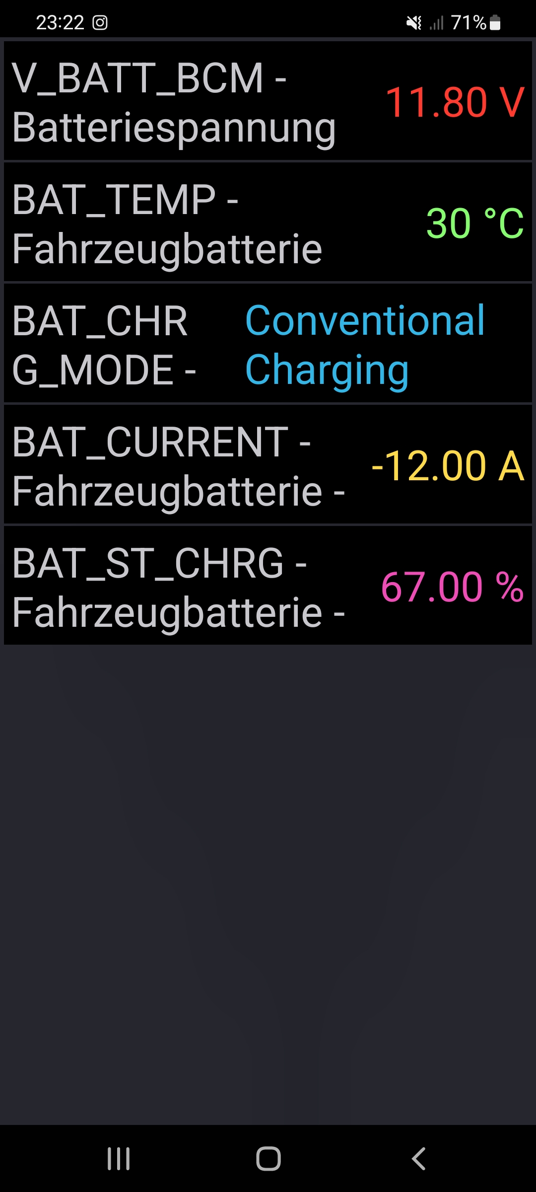

After a couple of hours rest i tested again..
SoC dropped to 67%, showed in forscan. The over 90% werent real. Thats correct.
My batterytester showed me a different SoC 79%. So everything makes no sense at all.

I don't understand it either. I don't use my car enough and my SOC in FORScan is normally between 50 and low 60%, but if I measure the Voltage across my Battery after fully resting the car it is normally 12.45 to 12.5 like your one, which should be about 70 or 80% :?:
Apart from Stop/Start only working twice this year, which I'm glad about because I saves my switching it off, I have not had anything else disabled because of low Battery charge.

On my 2016 the SOC is only accurately calculated when the vehicle sits overnight. SOC numbers change in real time while I'm driving, but the BCM needs a long period with no load to see how much the battery voltage drops. The voltage drop is used to calculate SOC.
