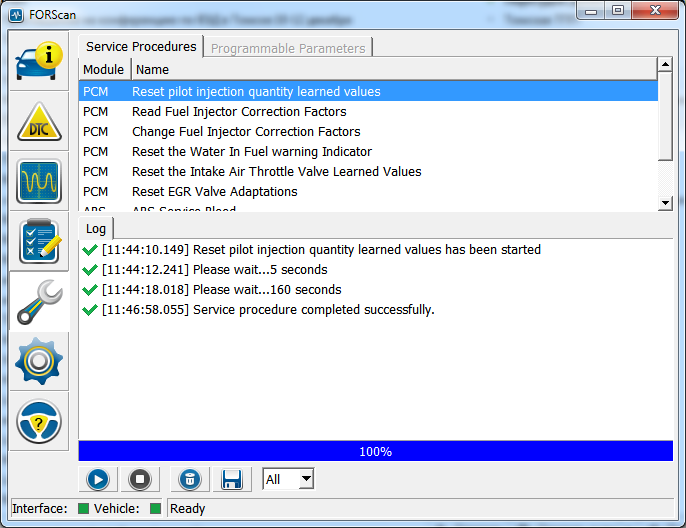

FocusMK3 wrote:"Reset pilot injection quantity learned values" done.
Fuel Injector correction factors before and after the procedure are the same. See attached image. The procedure apparently stuck indefinitely at 0% but I think it was ended. I had to stop it anyway.
Sorry, we don't quite understand. This is how the successful run of the "Reset pilot injection quantity learned values" should look like:
If it looks otherwise, please email us internal FORcan logs from your vehicle (if possible), thanks.
