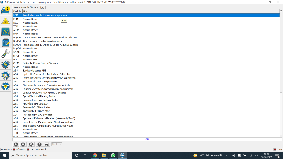

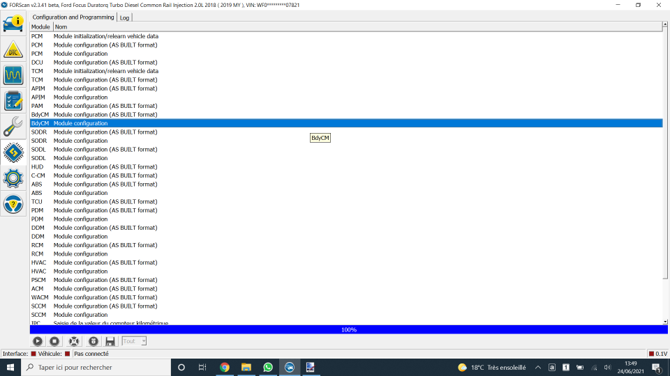

Hi all,
I bought an extended licence to Forscan but on my Focus IV SW 2.0TDCI 2019, I don't have access to the central configuration. Forscan never prompt any file (ab file or other). I can't add features :cry:
Sans titre.png (68.97 KiB) Viewed 17251 times
Sans titre2.png (73.9 KiB) Viewed 17251 times
