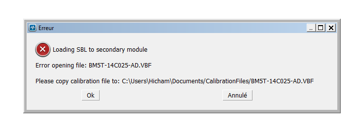

I can not enter programming, is there a solution for this problem ??

Hicham0277 wrote:Hi
The solution is suggested in the screenshot you pasted... check ForScan release notes.

lollapalooza wrote:
Hicham0277 wrote:Hi
problem solved, thank you
