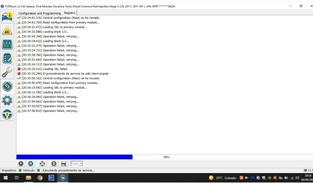

Hello. I come with a little problem that I have with a Vgate Vlinker FD interface. I connect with it to the Mondeo mk4.5 through pc, with Forscan (with extended license), in fact it works quite well, except connect to the Central Configuration of the BCMii. It starts looking for the SBL file, to download it and then it fails. The calibration files are downloaded in the corresponding folder. Anyone have any ideas? Thanks in advance
Excuse my English, message edited with translator.

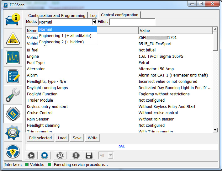

So what happens if you just downloaded FORScan 4-3-22 and you don't have THIS drop down box ?:
This is all I have
