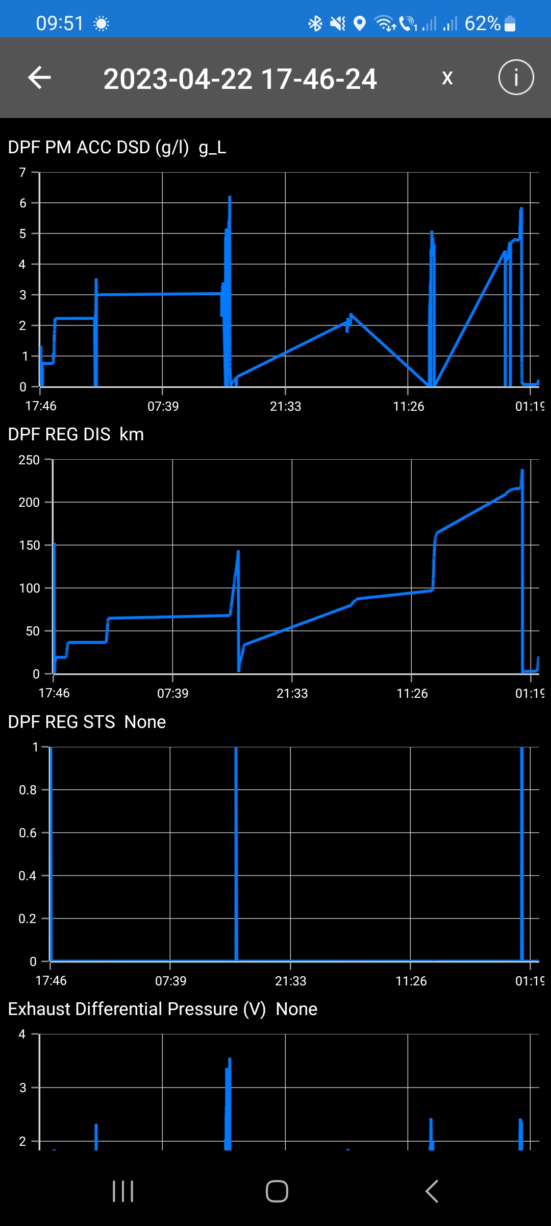

Hello,
In my case i think i solved the problem.
1-st, i did a chemical and water pressure cleaning of DPF.
2-nd, 3 - 4 runs on highway with the pedal to the floor until car reach max possible speed ( ~ 160 km / h ) and keep it there on lower gear ~ 4000 - 5000 rpm as much as possible. I thout the engine will blow up, is diesel, is not made to be used like this..
3-rd, used a cheap DPF cleaning solution that you put in the diesel tank. It cost about 7 euro but did the job.
After 1-st step, i did not noticed improvement, just the 1-st run i had 120 km between regen, then the car started to make again ~20 km.
After 2-nd step, i had 1 or 2 longer trips without fast regen ( about 100 km), but in the rest, car did regen every 20 - 30 km.
After 3-rd step, i noticed a big diference. 1-st regen at about 120 km, then 140 km, then 240 km... i never had these ranges before.
Now i'm at the 2-nd full tank and using the DPF cleaning solution, i will use again next full tank and after that i will stop using the cleaning solution and see if there are diferences.
I think not only DPF was a problem, but all evacuation system was dirty, including sensors, conections, etc...

What software are you using? This is not Forscan, right?
I would suggest you use Forscan with the following PIDs:
PM_ACC
PM_ACC_DSD
PM_GEN
REG_DIS
REG_REQ_A
EXHPRES1
DP_DPF
