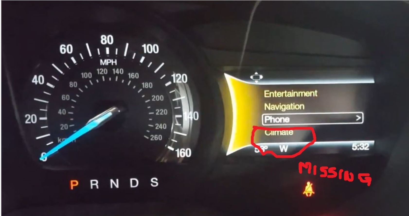

I updated my 2015 Explorer to Sync 3 and have all things working great.
I noticed that the climate control on dash cluster is missing
Does anyone know how to add it back through Forscan?
@clockwork Any help
@clockwork Any help
