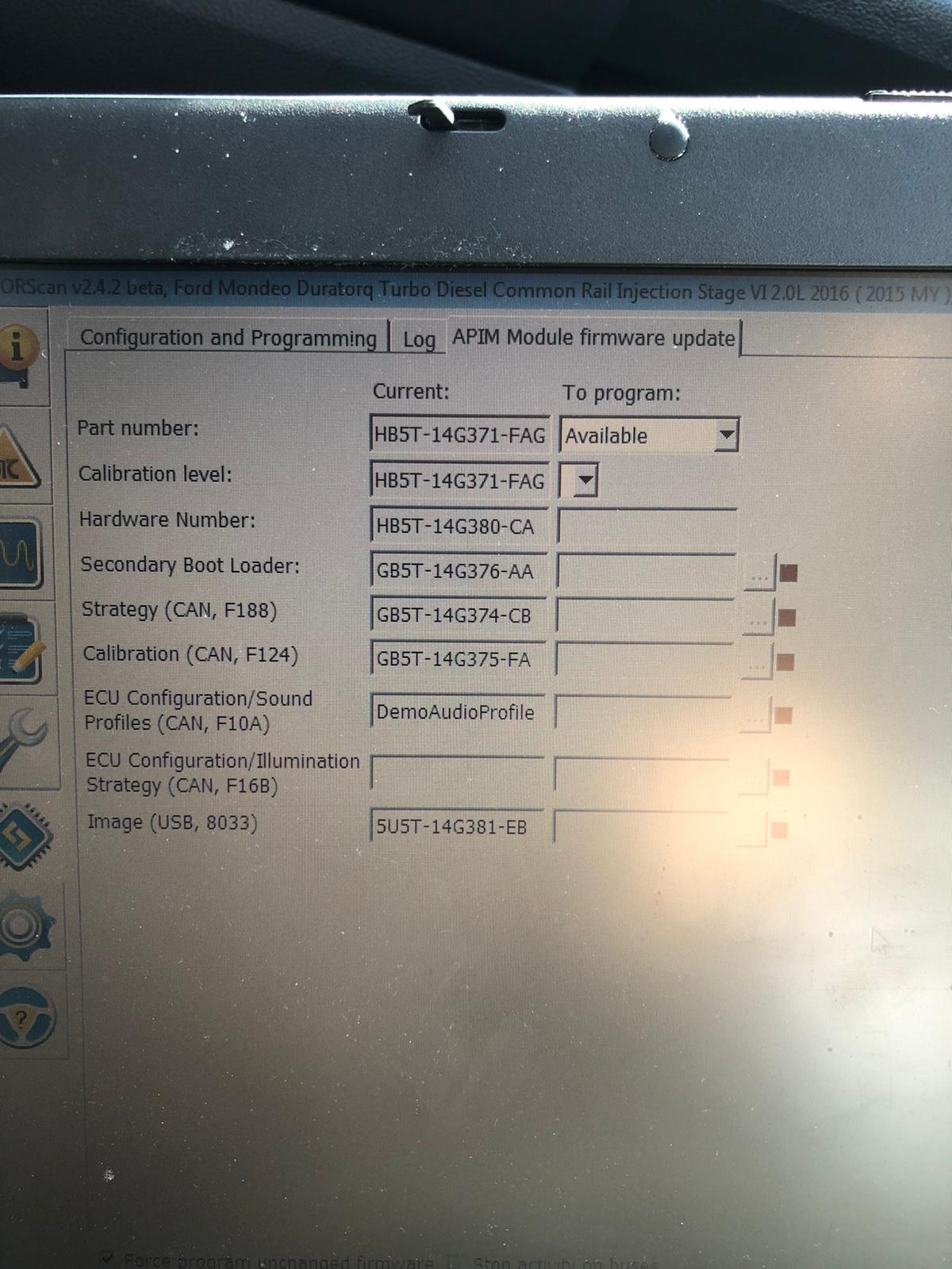

ok, for me 2.4.2 started to show available firmware for APIM.
one question I have. As you can see on the screenshot below - I have only calibration level is available - all others are showing "red" colour + not supported. Is it fine for me to go and update?

revelare wrote: Fri Sep 11, 2020 9:52 am ok, for me 2.4.2 started to show available firmware for APIM.
You have no update at this time.

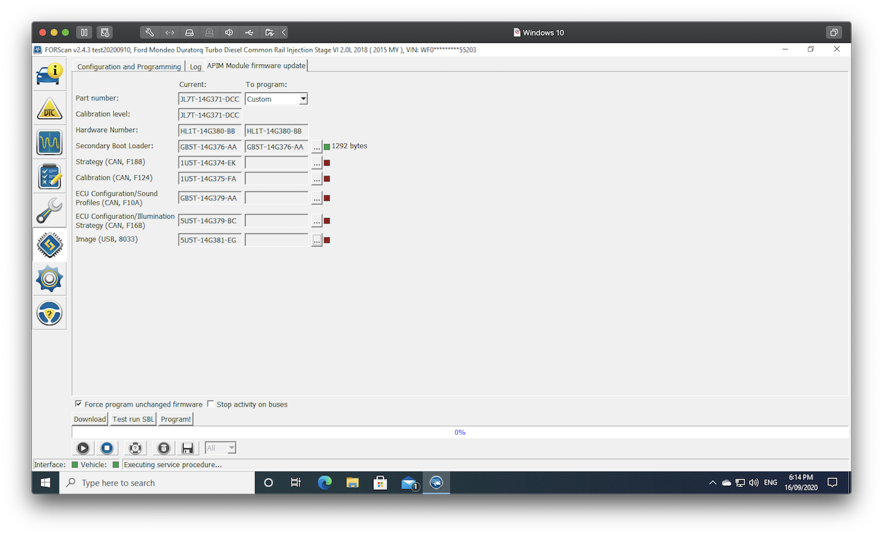

I had same issue. After change to Custom, I can't select any file for program too.
Had sent email with debug information to FORScan team.
