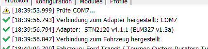

I have a problem with PATS programming
I have an ELS27 (2017 V1?) or UCDS dongle.
I always get the following error
ELS27
My problem is that the remote control no longer works
Code B10AB
I wanted to re-teach her
What can I do? Thanks

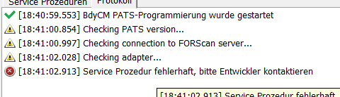

Hello i have a 99 ford transit 2.5lt epic and pats wont show on forscan using elm27 v1.5 how do i acess pats to program new key
Posts: 2109
Re: How to program PATS using FORScan v2.3.*
Post by tractmec »
carl1584 wrote: Tue Jun 04, 2024 12:20 am Hello i have a 99 ford transit 2.5lt epic and pats wont show on forscan using elm27 v1.5 how do i acess pats to program new key
Does your 1999 Transit even have PATS installed? All the PATS Charts I have for Transits do not show PATS being installed in the Transit Line until at least 2010!
The Charts I have are likely for the North American Market! The European or Asian market or other Than N/A may be different?

I have a problem with programming FF MK3 / 2016 - adding 3rd key in BCMii PATS
I enter BCMii PATS Programming,
A window pops up, I go through the question whether the car has a keyless system (NO), I go to adding a new key.
However, I get an error:
Make sure the master key is inserted.
Then it returns to the PATS programming function selection menu.
USE:
forscan 2.3.60
The car does not have a start/stop function (keyless access, standard CONTINENTAL 5WK49986 (15K601-AF) keys), two keys, one remote control, the other only a solo key (no remote control).
2 keys programmed and the option of coding additional keys is enabled
