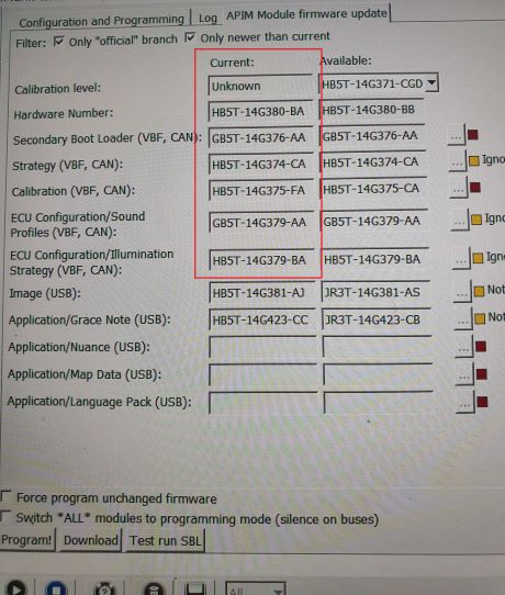

During the APIM update and at 99% an error popped up and the update was interrupted and now the radio does not work. Can you save it somehow? pops up when loading firmware: Unable to read current firmware p \ n:

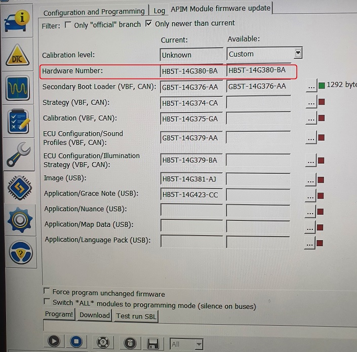

Failed to. Same error. Used Forscan 2.4.0 20200309

Are you able to get your Hardware Number?
