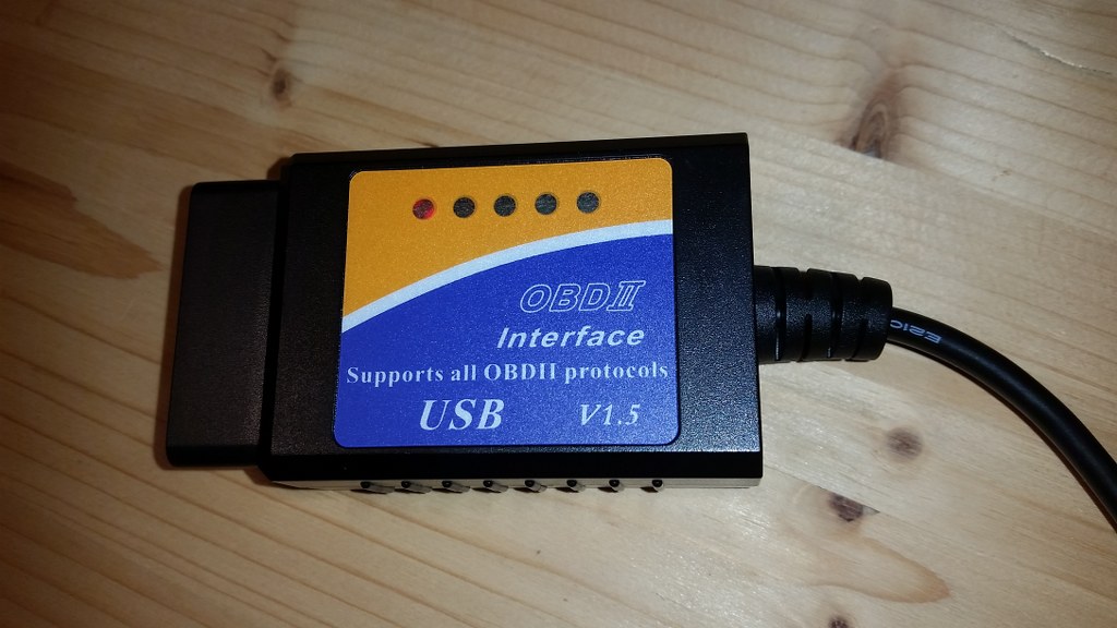

I'm having troubles to connect ELM327 v1.5 adapter with Ford Mondeo 2.0 TDCi 110kW.
FORScan connects with the adapter but doesn't with the car.
I have access to the car with ScanMaster-ELM program (Version 2.1, Build: 771).
I am trying to follow this guide to enable Navigation in Sync2 software (I need to change value in APIM Module. Will I need extended licence for that?).
Does anybody have any suggestions or should I buy the same adapter as it is in the guide?
Thank you for any help.
Some info:
OS: WIN10 Pro 64bit
Adapter chip: PL-2303 XA / HXA
FORScan report: ADAPTER: ELM327 v1.5, Unable to connect to vehicle...
adapter usb.jpg (141.19 KiB) Viewed 31015 times

Can someone please confirm that will this adpater from the guide actualy work or do you suggests different adapter.
I don't want to buy second non compatible adapter.
