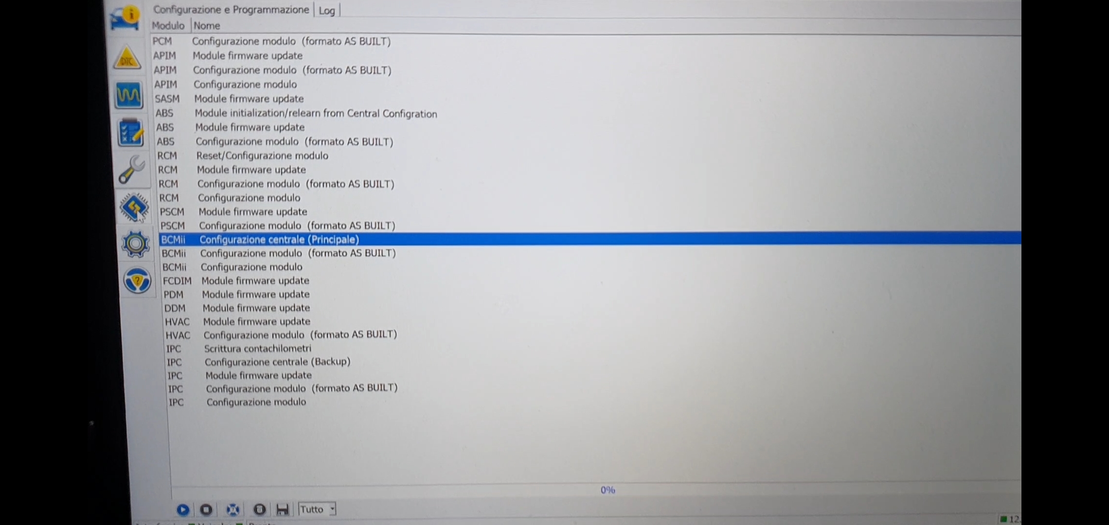

I have a European C-max from 2013 but I don't have the module described in the guide.
Maybe I should use another matching module?
- Screenshot_20211112-181513_Gallery.jpg (596.7 KiB) Viewed 9599 times
