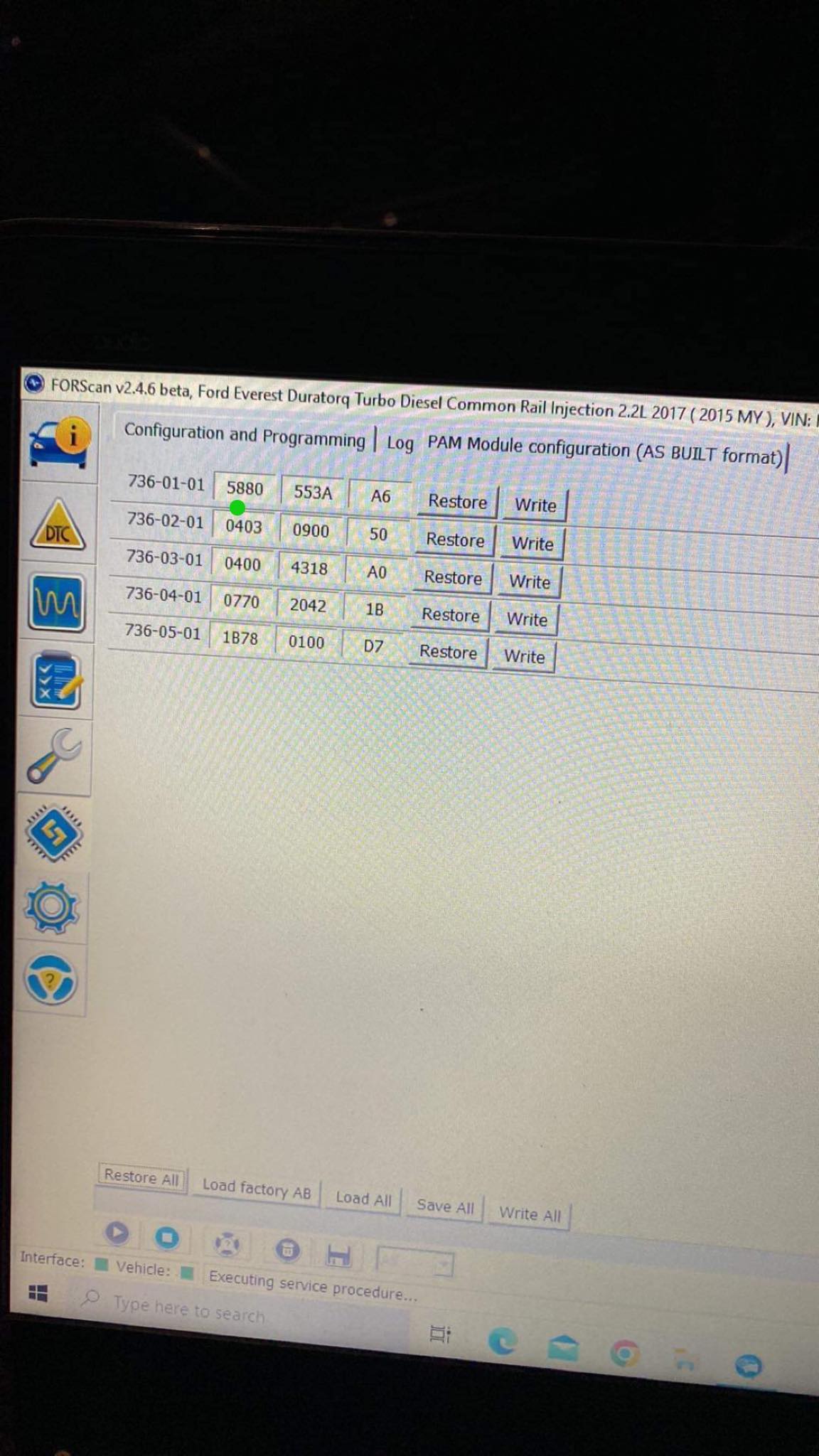

Hello everyone,i was just wondering if you could help me.I have a problem with the
configuration of PAM in ford everest 2017.I have installed 6 pdc(parking sensors)in The
front of my bumper.I can only activate
4+4=8(front +rear) i have tried activate 6+4=10 (6 front +4 rear),unfortunately it doesn't work
.Added Button APA,
PAM in as built data with green dot cant change 8 to A its always block configuration is ot compatible
any inputs to make this work....
thanks in advance
.Added Button APA,
thanks in advance
- pam as built.jpg (195.36 KiB) Viewed 828 times
- pam update.jpg (413.42 KiB) Viewed 828 times
