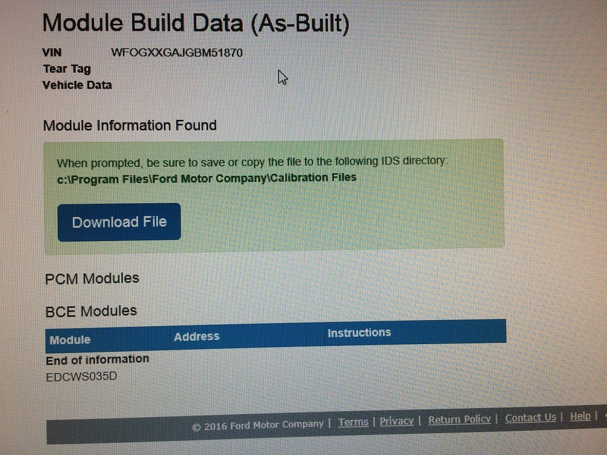

Hi Lollapalooza, I have read your guide here and am trying to do the same thing to my 2012 fiesta. Is it normal for the as built file to contain so little data as per picture??

thank you for quick reply, I have found out why, I put WFOGXXGAJGBM51870, instead of WF0GXXGAJGBM51870
