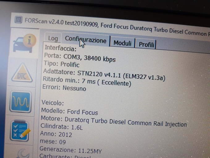

This is from April 11, before updating the adapter.
I saw that a user had the same problem as mine, user turbocip on 11 January https://ffclub.ru/topic/311647/jump_5730/
