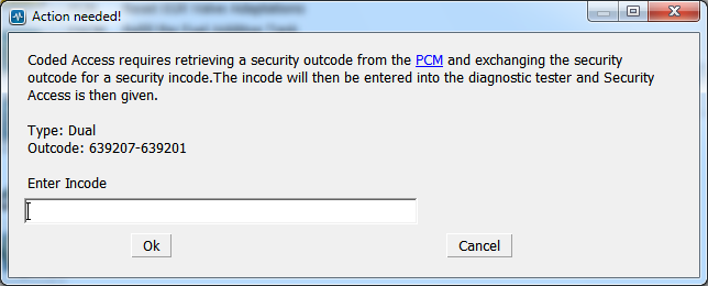

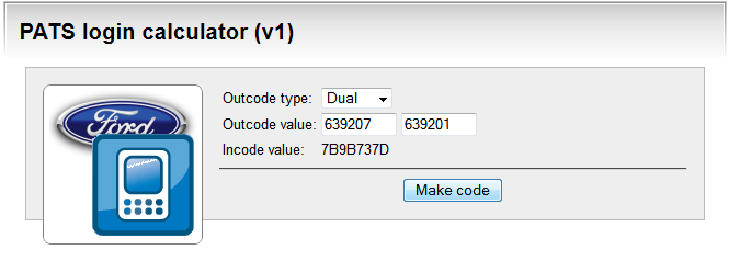

Another specific thing is that in some cases so-called Dual access to PATS may be required instead of Single access. Obtaining outcode/incode is identical with Single access, except that Dual type is displayed by FORScan and have to be specified in Outcode/Incode calculator.

iii. Do module initalization (Dual coded access may be required)

I have succesfuly replaced a transit 2009 dcu104 PCM with forscan with dual outcode
Thank you forscan team for your effort
