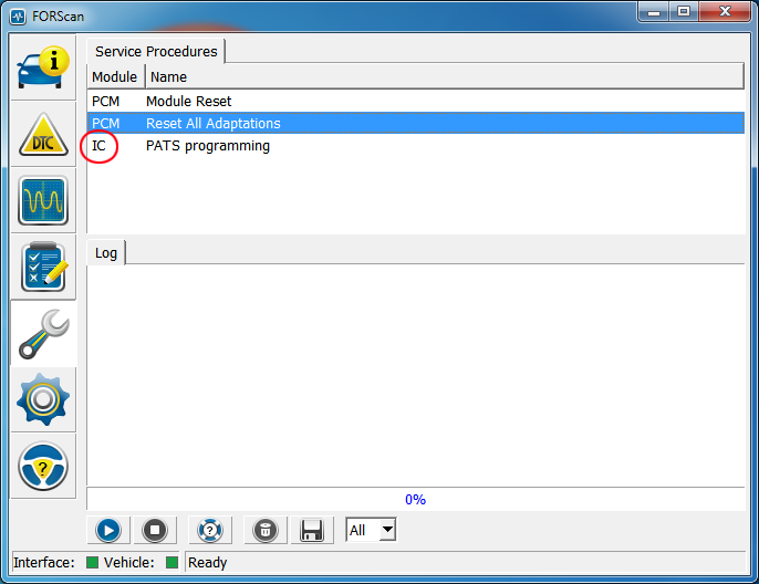

1. Detect the module that contains PATS. It is easy: go to Service tab and look what module contains PATS programming function. Depending on the vehicle, it may be PCM, PATS, IC, HEC etc.

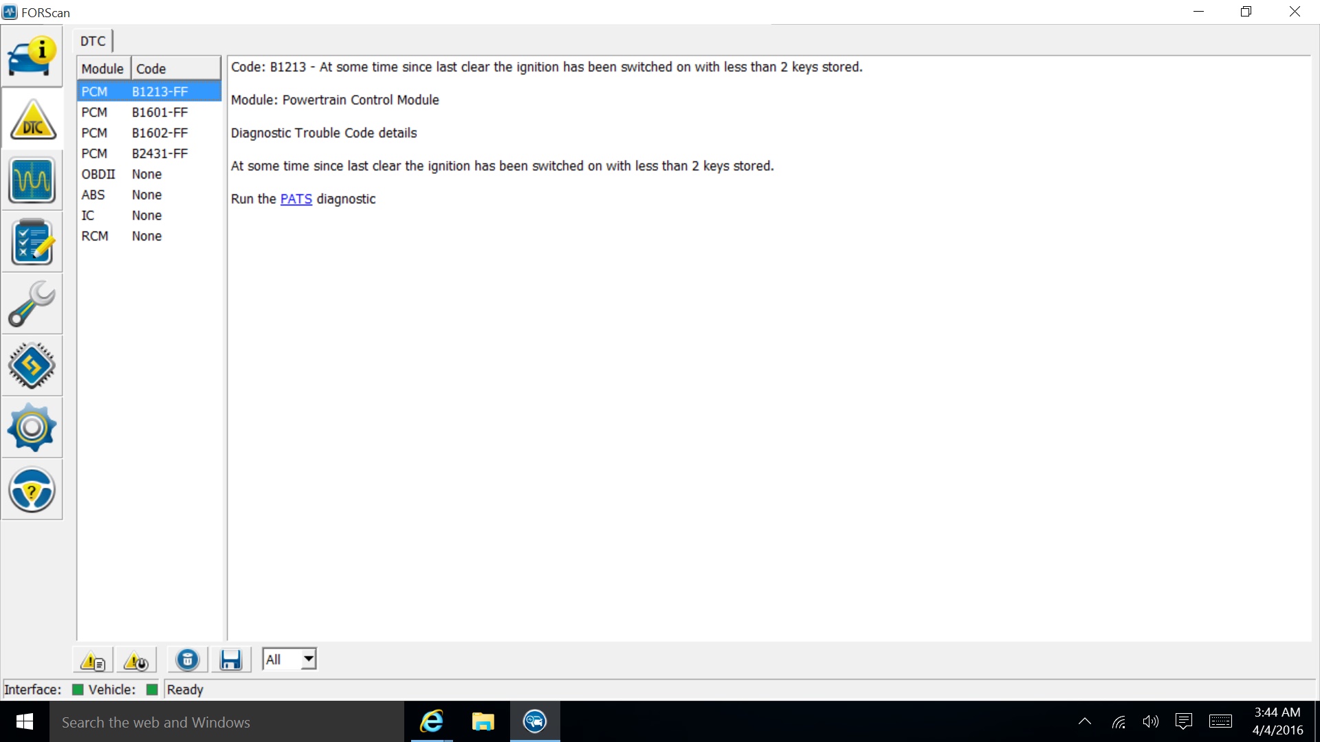

please help me. I had two working keys, decided to experiment with the Forscan Pats programming feature, now none of my keys are working
I only had one original key. I bought two blanks off ebay
http://www.ebay.com/itm/171866085789?_t ... EBIDX%3AIT
Forscan is not returning the B1600 so I'm assuming these ebay keys work. My original key is stamped ""S" but the new keys are 'SA". I understand S is 40 bit, SA is 80 bit but supposed to be backward compatible. But when I try to program it, the forscan software says the counter did not increase from 1 programmed key to 2 programmed keys. The original key programs successfully. What do I do please help.
Re: How to check blank PATS key
problem solved. just got back from the ford dealer. Paid them to get a new key made. The ebay ones do not work as the first two needed. The ebay ones only work after two oem keys exist. You need a Strattech brand key. It doesn't matter if they are S (40 bit) or SA (80 bit). Just as long as the brand is Strattech.
