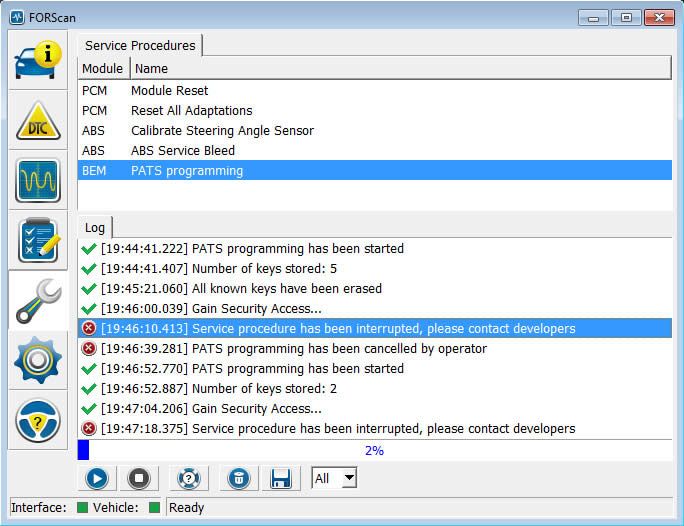

I figured that I’d have a go at resetting the keys with FORScan.
I wasn’t successful.
A message appeared: “Timed access PATS requires the diagnostic tester to enter into a runtime delay before Security Access is allowed. Continue anyway?”
I clicked on ok to continue.
I would then get an error message: Service procedure has been interrupted, please contact developers.”
I tried this a few times, but got the same error message each time.

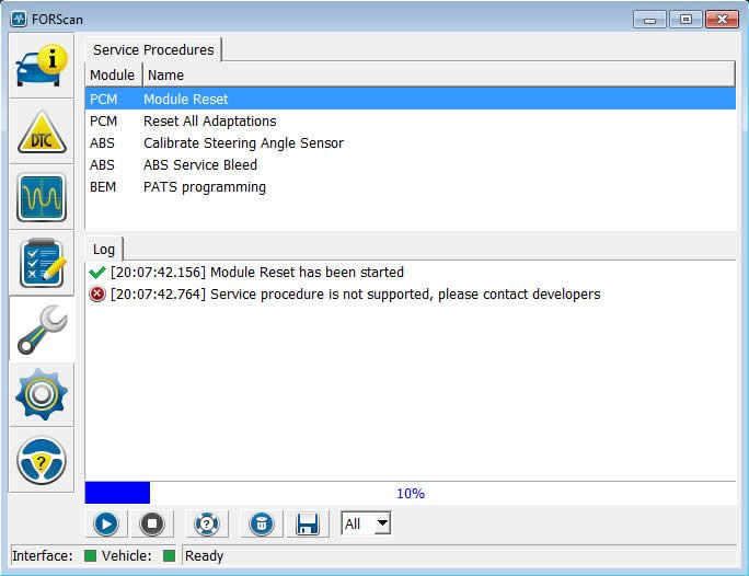

I then tried to do a PCM reset. This gave the error message: “Service procedure is not supported, please contact developers.”

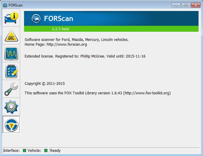

I had the extended licence in place:

We believe your vehicle requires coded access instead of timed (in contrast to earlier Falcons), this problem was fixed some time ago. Please install latest version 2.2.6 (just released today) and run the Module Initialization function with (not necessary to program the keys again). Please note you will need access to incode/outcode calculator, so if you have no one, please read this article first:
http://forscan.org/forum/viewtopic.php?f=6&t=839
Direct link to FORScan v2.2.6:
http://forscan.org/download/FORScanSetup2.2.6.beta.exe
