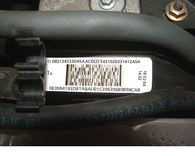

On 1.8 TDCi engines the label shows codes in physical cylinder order, not injector order (so (1) means cylinder 1, (2) means cylinder 2 etc)

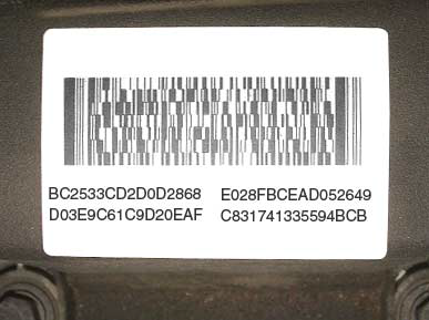

On 2.0 TDCi engines the label shows injector codes in injectors order (the top left code is Injector 1, cylinder 1 and the bottom right is injector 4, cylinder 2):
