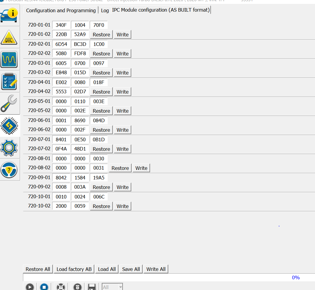

Can you post your IPC as-built line 720-32-01 and BCM line 726-58-02?

PlatinumOwner wrote: Fri Jan 21, 2022 3:45 pm Can you post your IPC as-built line 720-32-01 and BCM line 726-58-02?
My highest IPC as-built line is 720-10-02
MY BCM as built lline 726-58-02: 0000 0004 008B

I'm not sure if this IPC will support it but try
720-04-01 E006 0080

PlatinumOwner wrote: Sat Jan 22, 2022 12:04 am I'm not sure if this IPC will support it but try
720-04-01 E006 0080
I have the extended license and going into the plain english APIM, I enabled center stack controls and silent mode control. That then gave the option you have in your screenshot. Click it on and all lights stay off, perimeter and interior (except for sync screen which is fine). Click it back off and the christmas tree of lights is reactivated.
