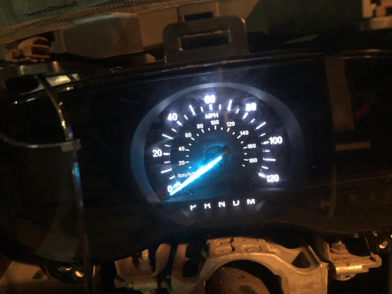

Dallas6
Joined: Sun Oct 09, 2022 7:52 pm
Vehicle: Expedition, V6 3.5/450, 2016
Re: ford expy 16 swiping instrument cluster to 17 (need help)
Post by Dallas6 »
it just shows light without anything
whether the switch is on or not
