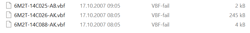

i was doing buckup on my 2006 galaxy and after loading firmwere cheksume wasnt correct . Forscan try several time to try another one but it cant finish . Now i have dead cluster with blinking turn signal .
after searching log i have problem with my own configuration read so forscan take one and download file to update . i think that was a problem .
maybe someone have original factory files for my ipc ??''
I PAY IN GOLD OIL CASH OR WHATEWERE YOU WANT

IPC - Moduł sterujący tablicą rozdzielczą
Nr części: 6M2T-10849-CK
Calibration level: 6M2T-10849-CP
Strategia: 6M2T-14C026-AK
Kalibracja: 6M2T-14C088-AK
VIN: WF0MXXGBWM6R17124

ok . it runs thanks to colegue .
DONT TRY TU UPDATE THOS OLD CLUSTER , THERSES NO FILES FOR IT !!!!
