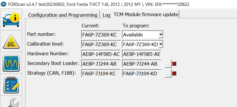

Hardware number for TCM currently in the car is AE8P-14F085-AC with the Calibration FA6P-7Z369-KC. SBL is AE8P-7J244-AB. Strategy is FA6P-7J104-KC.

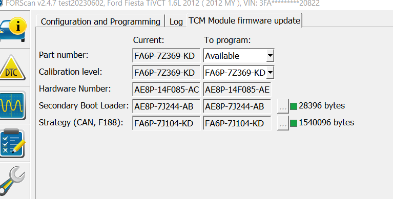

Using 2.4.7 beta with OBDlink EX cable I was able to upgrade TCM that is currently in the car to following (available option was used):
Calibration level: FA6P-7Z369-KD
SBL: (stayed the same)
Strategy: FA6P-7J104-KD
There was not enough time testing to see if firmware update resolved TCM issue, but I suspect it did not.

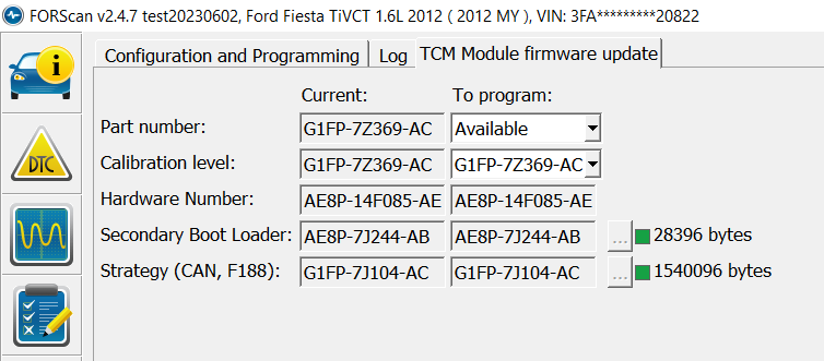

Used TCM from '14 Focus has a different Hardware number AE8P-14F085-AE.
Calibration level: G1FP-7Z369-AC
SBL: AE8P-7J244-AB (same as "original" TCM)
Strategy: G1FP-7J104-AC
Available to program shows the same calibration and other numbers, so I have tried to hit program to make sure it will program same thing over (should I not have done that?). Followed instructions, dashboard went dark, hazards flashing for 2-3 seconds, and then errors in the log.

"Original" TCM before updating firmware (I clicked on download after taking screenshot for boxes to show green)

"Original" TCM after updating firmware

Used '14 Focus TCM prior to attempting firmware update

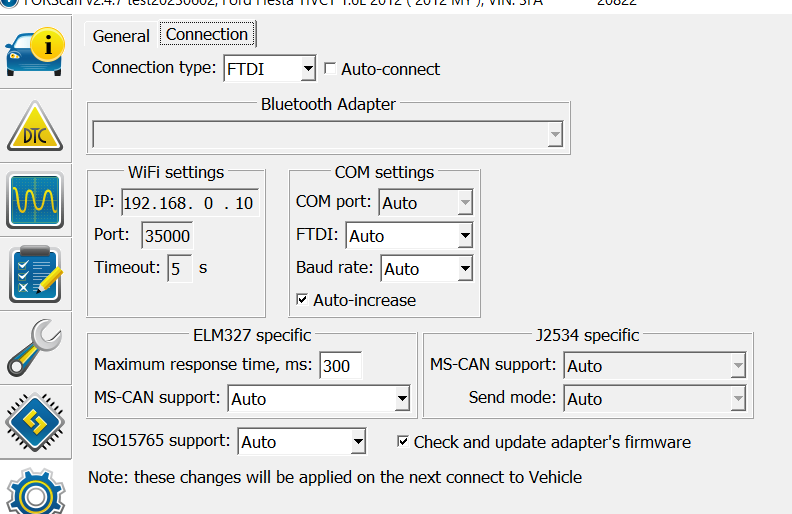

Connection settings page
