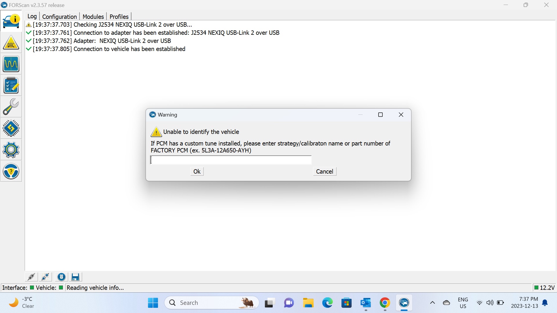

So, It shows its connected, but i get this error. Does this have something to do with the van being too new? or..
thanks in advance

donalddutch wrote: Thu Dec 14, 2023 12:41 am So, It shows its connected, but i get this error. Does this have something to do with the van being too new? or..
thanks in advance
More than likely yes! Email your Log and dump.bin files as per the instructions at this link: https://forscan.org/contactus.html!

Emailed, Thanks a bunch

Prob solved. Emailed Forscan, they sent me a new version. works good..

I have the exact same problem with a new Transit
I am currently using v2.3.58 with the Vgate vLinker FS Forscan USB obd interface
Sent on the Forscan Log to the support team so hopefully they can resolve it
